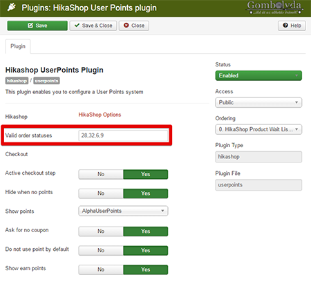

I think I get it,see the screenshot on below :
See "valid order statuses" ? You set here your order status Id, but it your order status Name that were awaiting here.
And so, file this value with for example : "confirmed" instead of "6".
Awaiting news from you.
Last edit: 10 years 5 months ago by Philip.
The following user(s) said Thank You: pepecortez

10 years 5 months ago #233830
Oh, shswssss... I was playing with it, but this tricked me. As in my native language the default statuses are translated, and I thought I have to give in that field the ids...

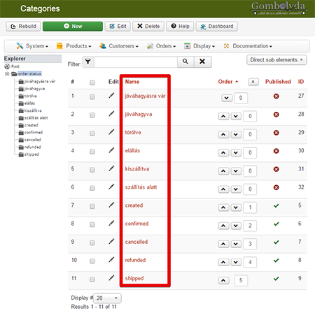

10 years 5 months ago #236639
It seems that your 2 issues are linked to the same thing : your custom status "Feladva", the clue is that your order pass through "feldava".
In Components => HikaShop => Configuration, Order part you must define how must be treat your custom status.
For the user points and stock return, to give or not point and leads stock depends from statuses, and in your backend configuration feldava is unknown...
Before process an order HikaShop looks his actual status (and his configuration) if HikaShop don't understand actual status issue can appear.
If this status is really required for you, define his categorie among cancelled, confirmed, refund etc...
Hope this will help you to solve this.

10 years 5 months ago #236773
Thanks Philip for checking it so fast.
Now stock set back if order is cancelled is OK, that was because that not all the statuses was set in the config page - as you wrote.
But the gaining points problem still not solved... It was true that there was a misspell in 'feladva' status. This means in our language, that 'it is under delivery', it's on it's road to you. So this should be a status just before shipped. (shipped = arrived to you, it's in your hands) But fixing to the correct status name also do not helped.
I've played a lot with the plugin, but anything I gave in the plugin parameter was not working correctly (worked as earlier described), only if the 'confirmed' status was set. In that case (confirmed) it worked like a charm. Please have a look at it again, because I feel myself so retarded, that you can not imagine... You can modify in config the statuses, also in the plugin settings I give you a free hand, please make a test order. System should give the user the points when the status is 'shipped' or 'feladva', and of course it shouldn't remove points from user if the status was not set to 'shipped' or 'feladva' before. That's our case what needs an ASAP solution.

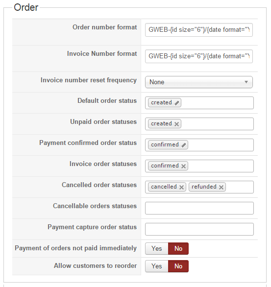

10 years 5 months ago #236856
Let's explain simply your actual status configuration :
- Default order status => created : OK
- Unpaid order statuses => confirmed created : Confirmed isn't a paid status ? Why ? That can explain point weird point move.
- Payment confirmed order status => created : First step for being paid is "created", that's contradictory with "Unpaid order statuses", can brings issue too
- Invoice order statuses => confirmed feladva shipped : OK but does this is really usefull? Note, edit an invoice for Unpaid order statuses can be logical and so won't work.
- Cancelled order statuses => cancelled refunded : OK
I suggest you this configuration, an advice made more easy.
Hope this will solve your point issue.
