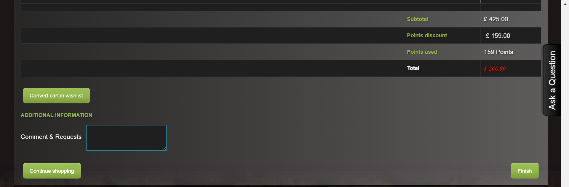

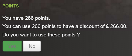

When someone tries to pay with points but they don't have enough points for the entire purchase the total and points used are reversed. See screenshot.

WHen a user has enough points this does not occur by the way. Only when they don't have enough points.

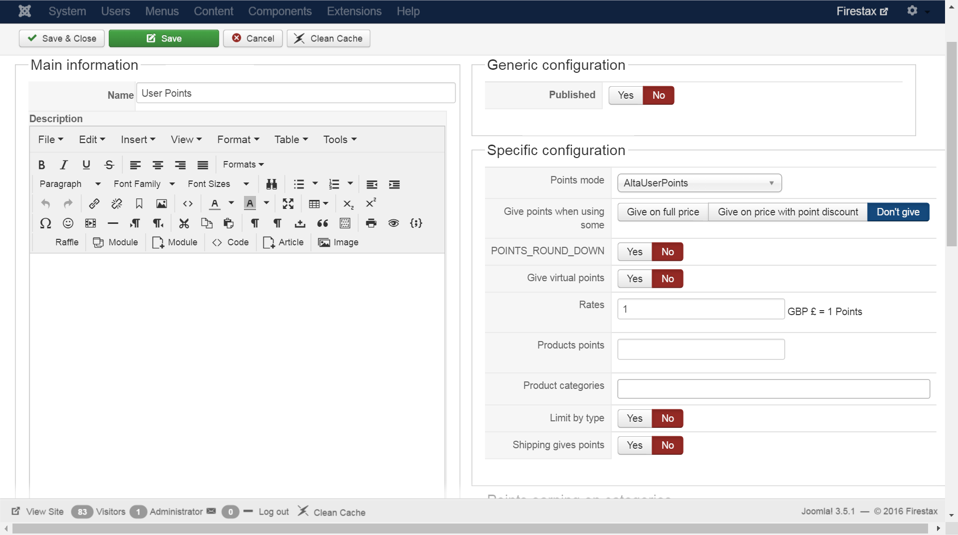

Can you check that the option "Give virtual points'" of the user points plugin (menu System>Plugins) is turned off ?
It should be turned off in most cases, and it's probably what is causing the problem there.

I don't see that option in that plugin.

Go in the menu System>Plugins of HikaShop, not in the Joomla plugins manager.

I have that turned off because I thought that was for earning points. What should the setting be if I don't want to give points when someone checks out. We use the points like our own currency and don't want to give out free money. :)

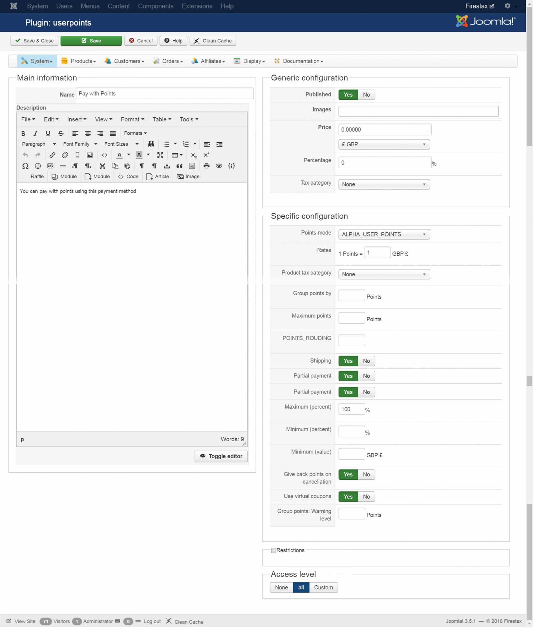

Mmm. I'm not able to reproduce the problem.
All I can think off is that you set some kind of limit in the settings of the user points payment method in the menu System>Payments.
Can you check the settings there ?
IF you think they are correct, could you provide a screenshot of the settings there ?
The following user(s) said Thank You: firestax
  • Posts: 57
10 years 5 months ago #237041
Here is the settings.
  • Posts: 86216
  • Thank you received: 14222
10 years 5 months ago #237143
Mmm. I don't see a problem there.
