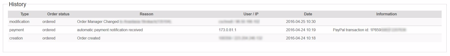

I have an issue with paypal payment method. For some orders, payment notification is received by paypal plugin but hikashop does not change status. It shows "automatic payment notification received" and transaction id but status remain same.

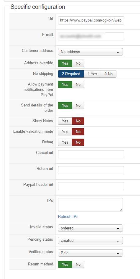

This means that there was probably a problem with the payment notification.
Please turn on the "debug" setting of the PayPal payment method and try again.
You should then get the debug data in the history data of the new test order and that will provide more information on what's going on.
Our FAQ on that actually provide more information on what to do in such cases:

I have checked this further and found issue was mismatch prices. Could you please suggest what can I do to fix this?
paypal_amountorder_full_priceorder_id
719.88USD719.905228557
1078.96USD1078.973468524
383.80USD383.811228570
Thanks,
  • Posts: 86216
  • Thank you received: 14222
10 years 4 months ago #239438
It's probably because you have the "send order details" option activated in your paypal payment method and that the "round prices during calculations" setting of HikaShop's configuration is turned off. Thus PayPal calculates the total itself, and it does it differently than HikaShop. Change one of the two options and it should avoid the problem.
