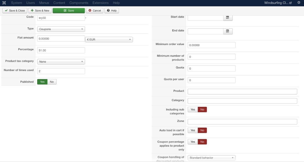

  • Posts: 4
10 years 4 months ago #240137
Allo Nicolas, bonjour du Québec!
Here's the screenshot you asked (the coupon setup) :
There's taxes for goods shipped in Canada, no taxes for goods shipped in USA.
Taxes setup are below :
Il will try to play with those settings and be back to you. In the mean time, I hope this provided info will help to resolve the problems. Thanks.
