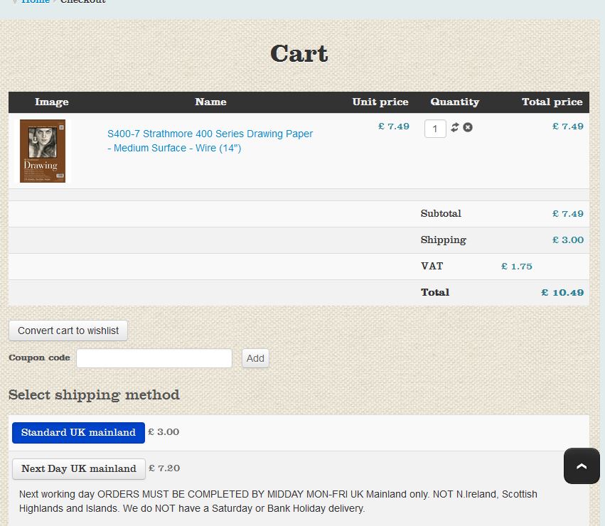

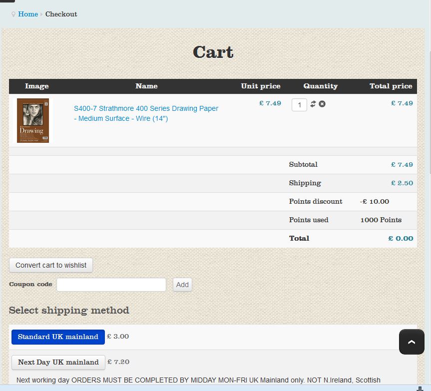

I've encountered some problems using Hikashop points plugin for payment. I am using the custom field method to grant users points via back end admin.
In the cart at checkout, if the user doesn't have points shipping is listed inclusive of VAT (correct).
If the user has points shipping is listed without the VAT (incorrect)

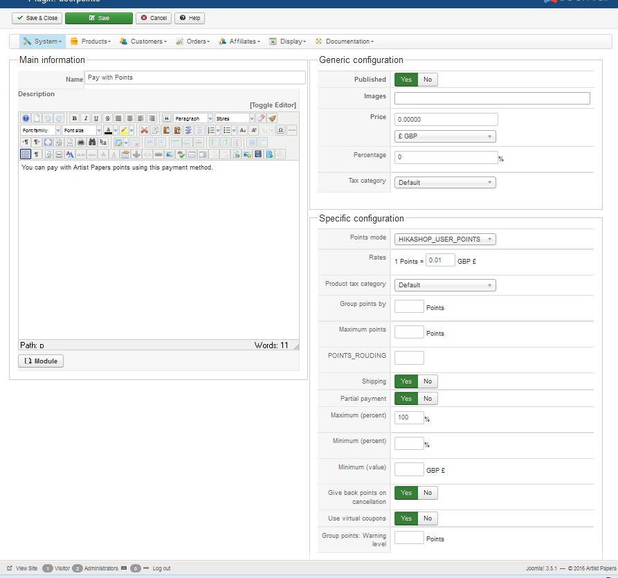

Hi Jerome,
Attached is screen shot of my "Pay with Points" configuration
You can see from the screen shots I posted originally, the shipping price includes tax when there are no points used, but when points are available the shipping shows without tax - this is on exactly the same order.

I was hoping that someone from the HikaShop support team will handle it but...
With your screenshot it's not possible to understand what is the "default" tax category and what kind of tax rate it is.
So I can't say if "1000 points" are really "10€" discount or if it should be another value.
The fact that you have enough points to pay the full order and that you also include shipping might be the source of the problem ; but more data would be necessary in order to understand it clearly (just one example is not enough to understand how it reacts).
Problem might comes from the function "finalPriceToPoints" in the case when there is a "order_subtotal" but that price do not include taxes. When the rest of plugin did not handle taxes it wouldn't be problematic but since that support has been made, it could be a source of problem.
