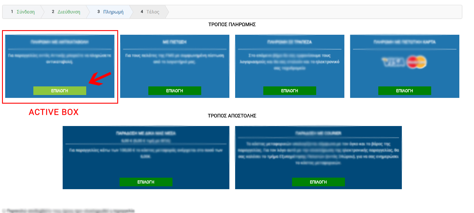

Hello again!
I need to change the payment methods table layout, instead of rows i want to display the payment methods in columns.
I believe i can do that in the file checkout / payment.php? But i m having trouble changing the correct <tr> to <td> etc.
I also want to do that for shipping methods too!
Could you give a hint please?
Thank you!

Yes, it's indeed in that view file. And in checkout/shipping.php for the shipping.
I would actually remove all the tr/td/tbody/table tags and just have one div for each payment method/shipping method with a float:left and a width:25% of the divs so that it would display on four columns automatically.

Hi nicolas,
thank you for your answer.
I removed table tags, but the payment methods are still displayed in 4 lines.
How can i create 4 divs in the view file, 1 for each method?
That's my php code now

You have two things to do:
1. You have a problem with yours divs:
take.ms/pQJvP
They are one into another because you're missing a closing div for each row.
2. You need to add a float:left and a width:25% with CSS on the divs so that they can display one next to another.

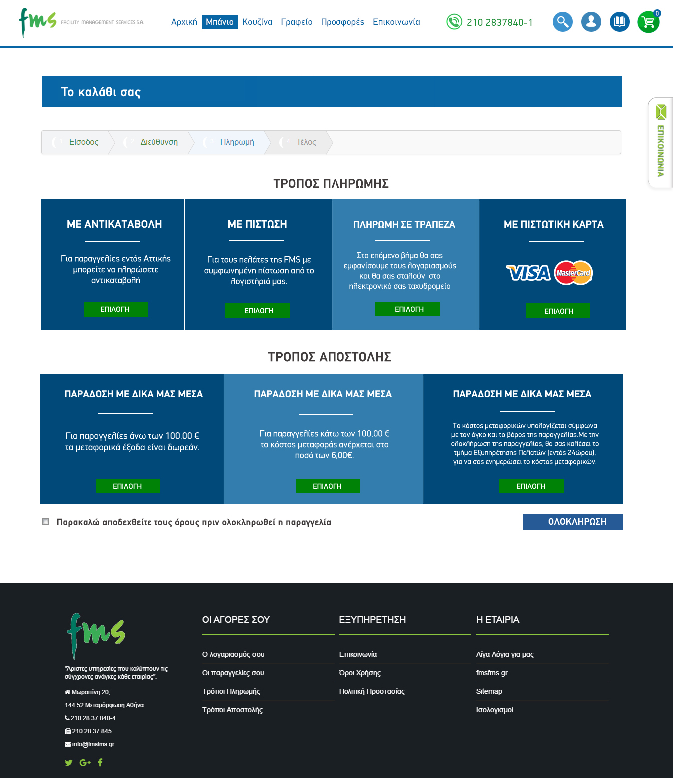

Ok i see what you are saying!
I fixed it i think but the problem now is that the class that i created doesn't recognise the css that i give it.
I added the CSS you said but no result unfortunately.
Ok, i found it.
For some reason it doesn't see the custom.css file so i added the css code in frontend-default css file and it's ok.
But the code that i added that is for panelboxes to have equal height does not work in the payment view file but it worked in the login view file. I don't understand why!
I m talking about this line <div class="uk-grid" data-uk-grid-match="{target:'.uk-panel'}">

Hello!
i created panel boxes instead of table ok, one question:
when i choose a shipping or payment method the active button changes background (see screenshot), what i would like is the whole box to have different background. Do i need some php here maybe?
Could you help me with this?
Thank you
  • Posts: 86216
  • Thank you received: 14222
10 years 3 months ago #243339
Again, that's not a HikaShop question.
Here is a page which talks about adding CSS to a parent element of another element:
stackoverflow.com/questions/8114657/how-...hild-element/8114664
