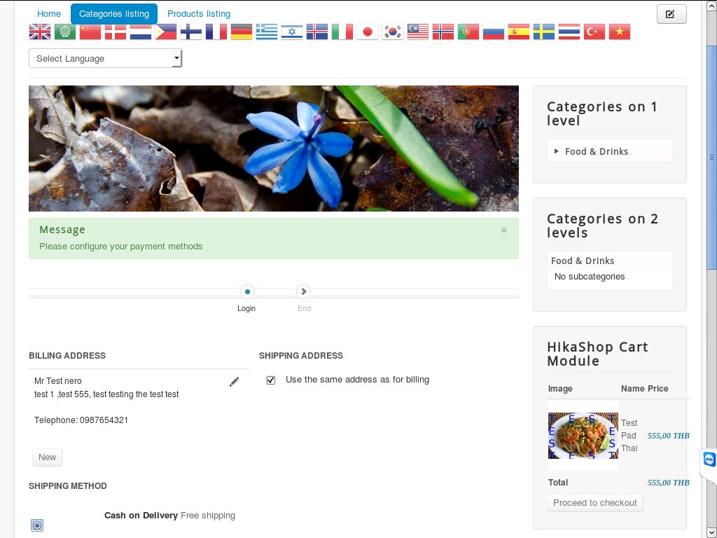

i keep getting this error message "Please configure your payment methods", but when i try to set a method, i couldn't find the option which i would like to select, which basically is only to accept "cash on delivery".
When i click on the only button at the bottom "Finish", nothing happen and i keep being bounced back exactly on the same page like if i only pressed to refresh the page.
There is any ways to get rid of this error message, and once someone click on "Finish" the customer get into a page that say the order has been received/accepted, while at the same time the Admin get a notification of the new order just being made????

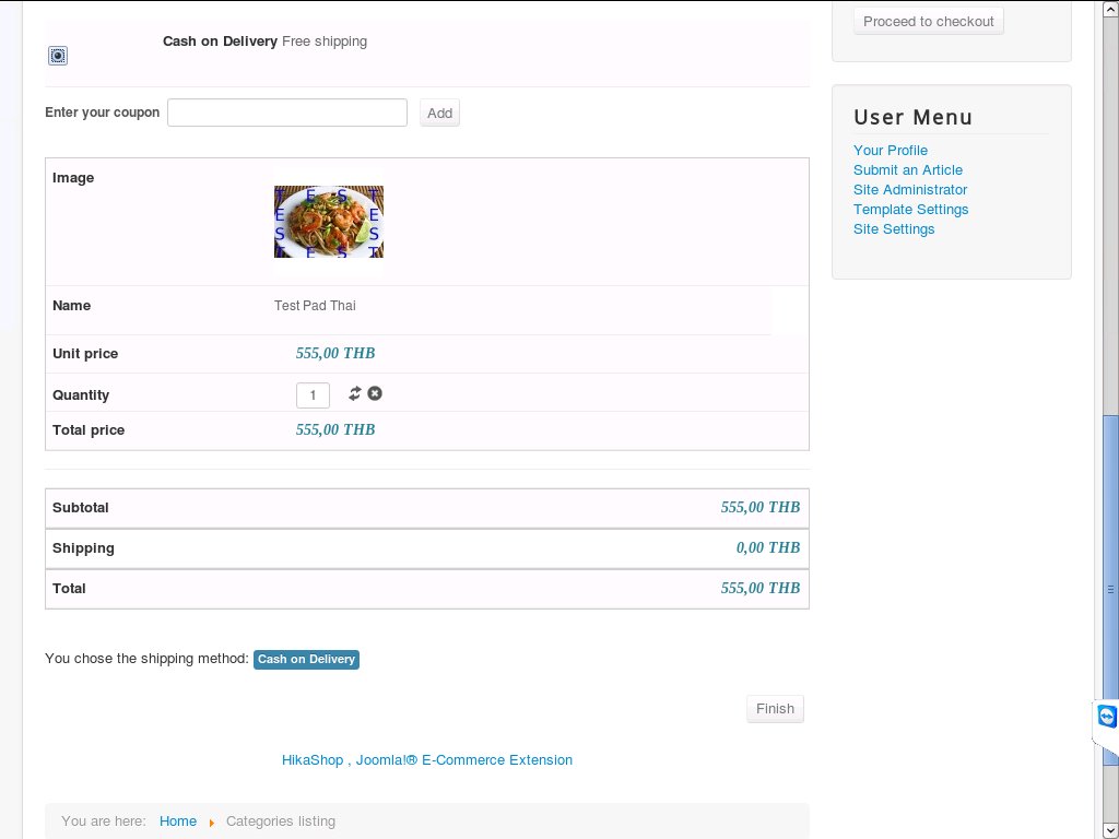

Getting back on my original issue, i didn't know that i needed to enable that plugin ( "HikaShop collect on delivery payment plugin" ), at first after reading about it i thought it was some other external app that i needed to download, then i found someone mentioning that the "collect on delivery" was a plugin, so i went looking for it and i enabled it.
The problem it's still there, even if this new option is ticked on the check-out page, ironically the HikaShop is still displaying that error message telling me that i need to configure the payment methods first, and when i click "Finish" to finalize the purchase, nobody receive any confirmation about it, not the customer nor the vendor, something it's clearly broken or misconfigured here....

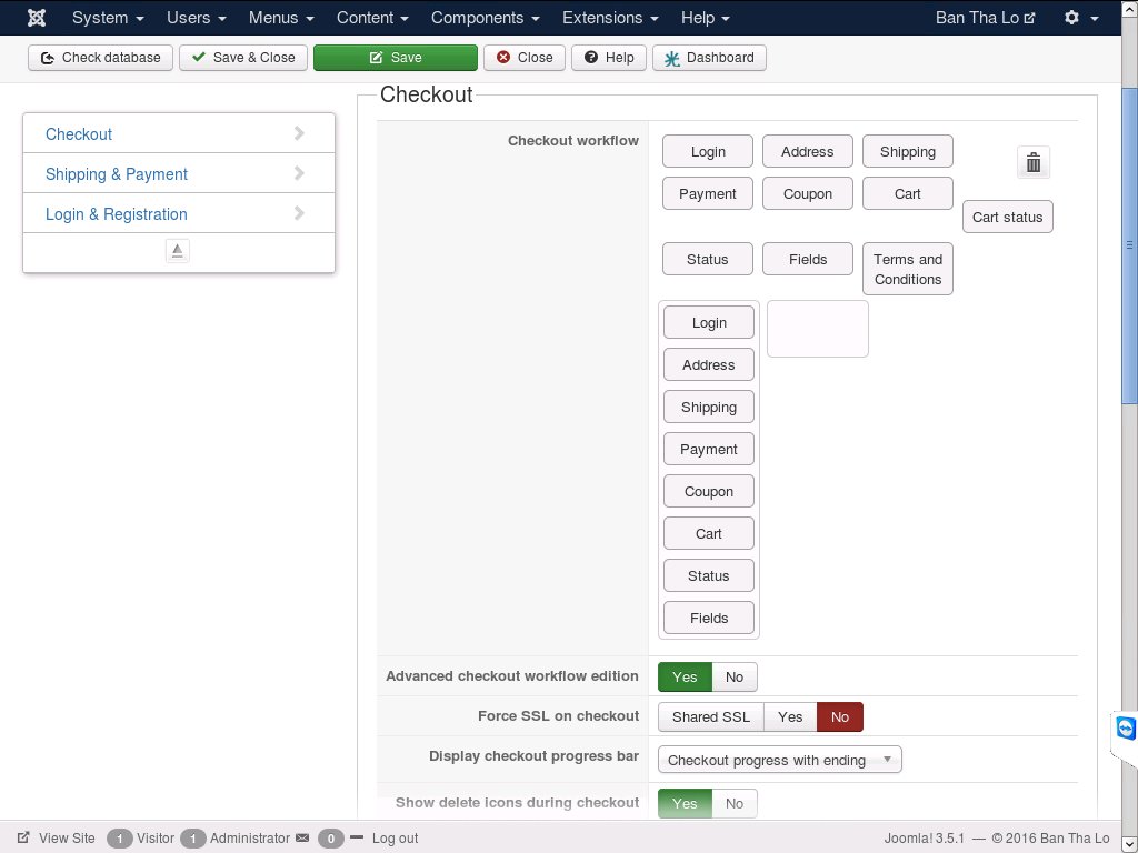

10 years 4 months ago #240847
If you don't need any payment, then you can simply remove the "payment" veiw from the "checkout workflow" setting of the HikaShop configuration.
