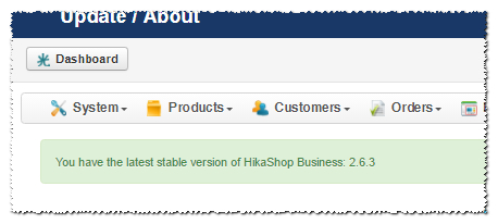

I see on your website that you have HikaShop 2.6.2 and not the 2.6.3
We've actually modified the authorize.net payment plugin with the 2.6.3 to better handle the notifications so please update.

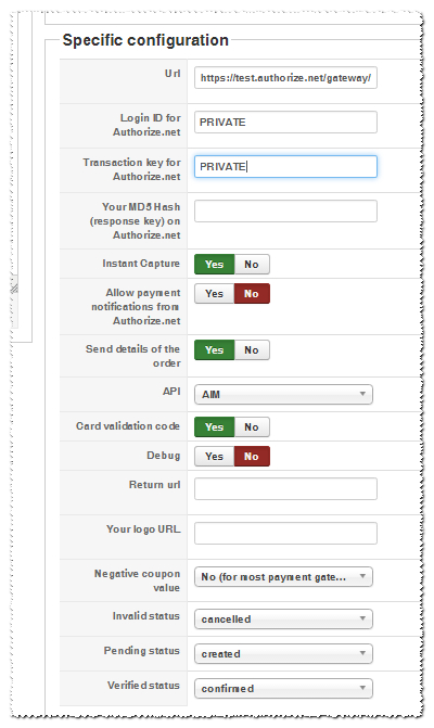

No, they do not want it to work like PayPal, they don't want the customer to leave the site. I only mention PayPal because the order confirmation e-mail that we designed works properly with that payment method.. We simply want our personally designed order confirmation e-mail to be triggered when the payment comes back as approved.. I did try SIM and that didn't give me a confirmation e-mail either, only the ugly authorized.net confirmation e-mail
By the way, we also have another client who uses 2.5.0 and I used my developer authorized.net credentials and the order confirmations come in perfectly as they should be.. but with 2.6.2 and 2.6.3 our custom order confirmation e-mails do not work.
Surely this is possible, I've looked at the code and you can see when the order is approved by the response code, so it seems like it should work.. and like I said, on our client site that is running 2.5.0 it DOES work.. so there's a problem somewhere

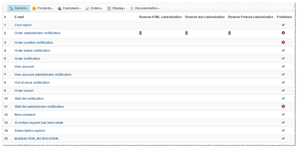

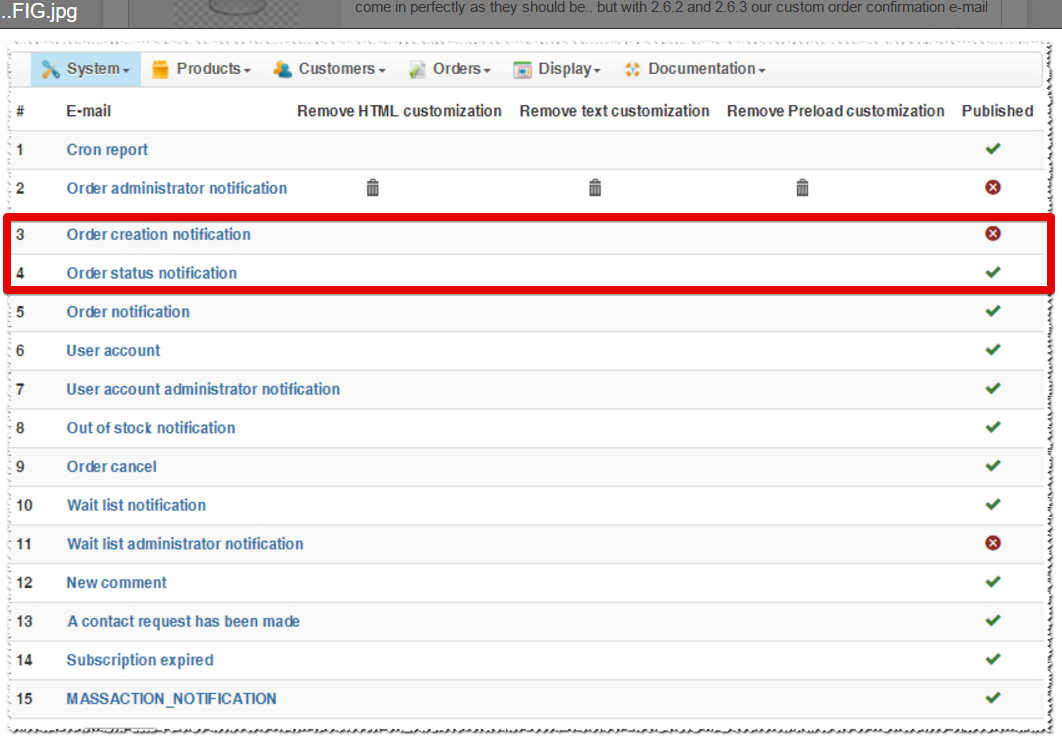

The screenshot www.hikashop.com/media/kunena/attachment...637/EMAIL_CONFIG.jpg is quite strange.
There, I see that the only email that you customized is the "order admin notification", but you disabled it.
So what is that personnalized email you customized ? The order admin notification ? In that case, you should enable it.
The order status notification ? But it's not written as being customized on your screenshot. Did you remove the customization ?
  • Posts: 31
10 years 3 months ago #243233
The admin notifications should be irrelevant? .. I disabled it because they no longer wanted those.. they've been disabled for a long time so that shouldn't be the issue... the notifications were working long before that was disabled using another payment type.
I can provide you FTP and Admin if you want to take a look at it.. I set up a test site on another server even to try to eliminate a server problem as being the issue but that, as I suspected, wasn't the problem.. we do have another test site where it does work so I'm at a loss..

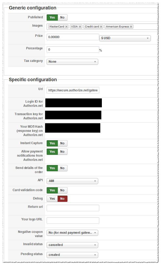

Let's talk steps by steps,the way authorize.net works :
- When an order is created and finished, his status is already define on "Confirmed"
And so the only way that authorize will notified the customer is the "Order creation notification" that you disable
Note that for other classic payment plugin, the plugin will mute order from created to confirmed or canceled.
BUT here, for Authorize.net in AIM mode no status is necessary and so no order status notification.
So, as Nicolas told you, for authorize.net in AIM mode you want a notification you have to published your order creation mail (very closed to Order status notification) and maybe custom it if required.
