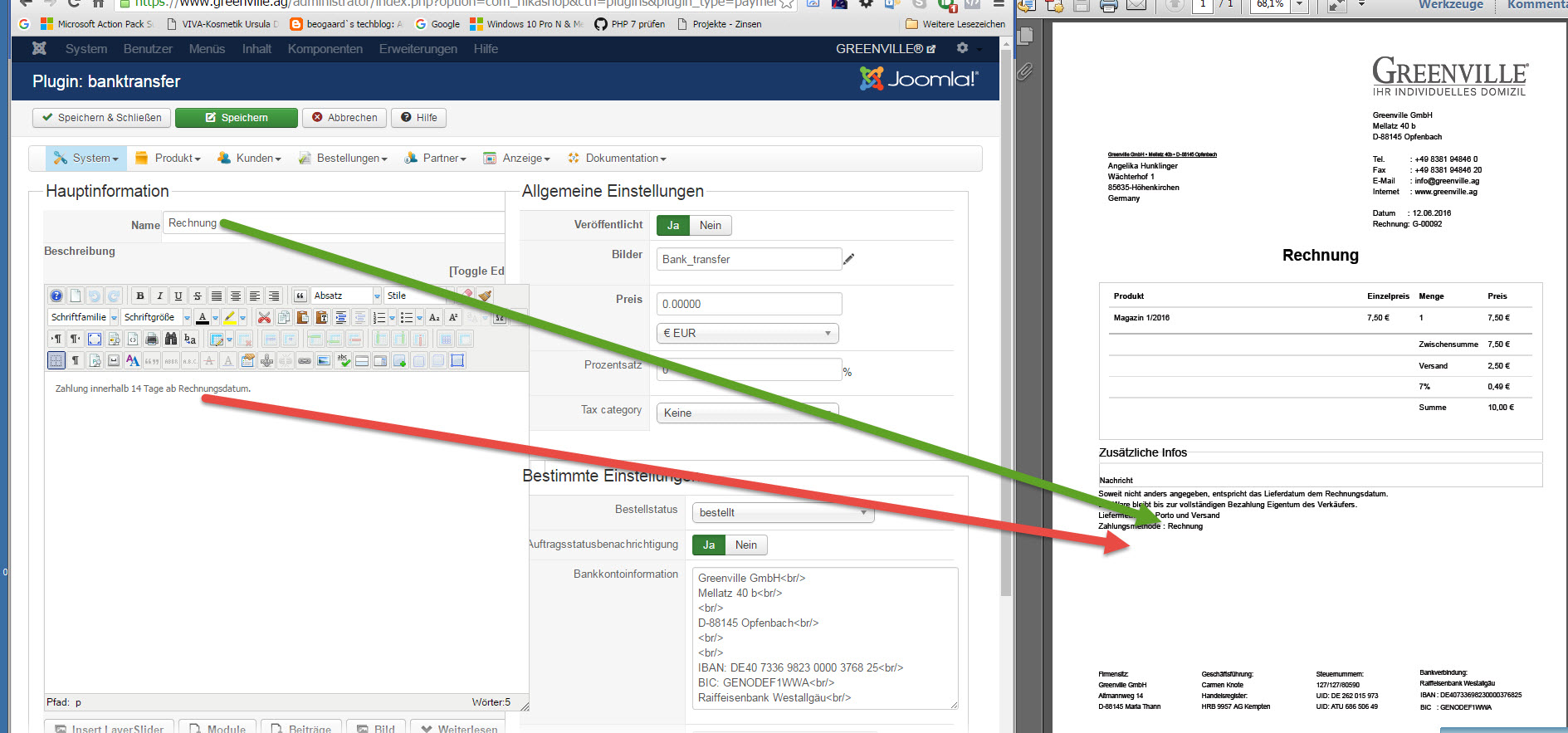

-- url of the page with the problem -- : www.greenville.ag/shop
-- Joomla version -- : 3.5.1
-- Error-message(debug-mod must be tuned on) -- : How to show the field "payment_description" on the invoice

  • Posts: 41
10 years 3 months ago #242804
10 years 3 months ago #242808
To do that the solution will be to directly edit the code of the "Invoice" file of the "Order" view of your back-end template via "Hikashop->Display->Views" and add your code just after these lines :
<?php if(!empty($this->payment)){
	echo JText::_('HIKASHOP_PAYMENT_METHOD').' : '.$this->payment->getName($this->order->order_payment_method,$this->order->order_payment_id);
  • Posts: 41
10 years 3 months ago #242978
That is the question. What code exactly that I might get the contents of the table field "PAYMENT_DESCRIPTION" ?
.....$this->payment->getDescripion ...this function does not exist
Torsten.E
10 years 3 months ago #242985
The solution can be to do an SQL request on the #_hikashop_payment table and retrieve the "payment_description" field of the row which have the payment id equals to : $this->order->order_payment_id
