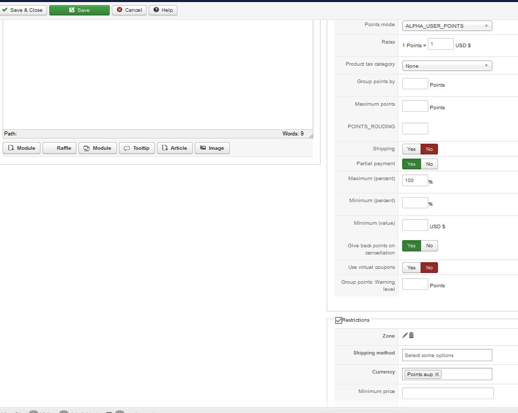

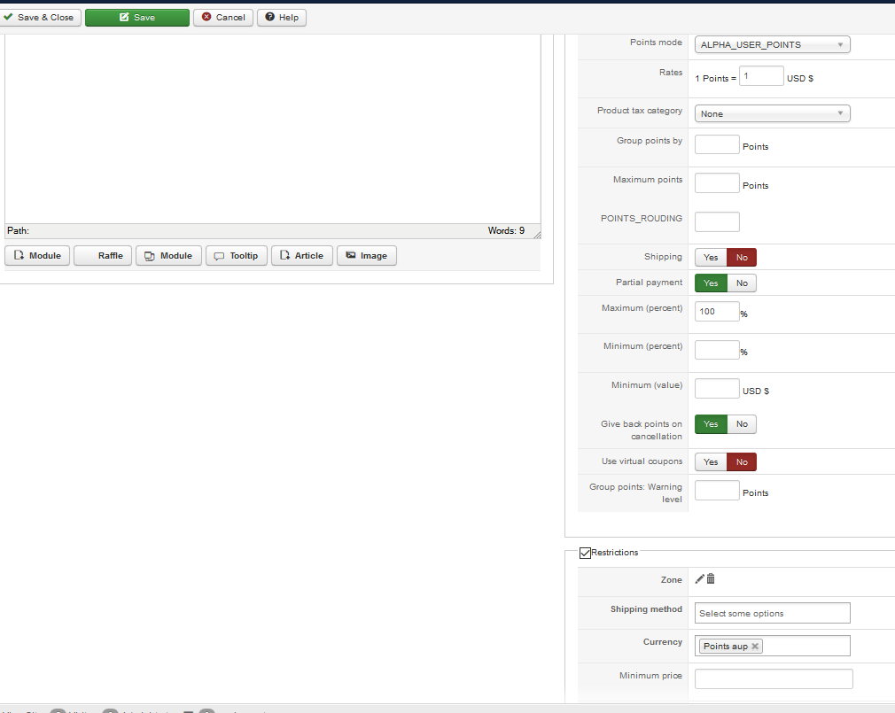

1st shot is the AUP Pay with Points payment method screen

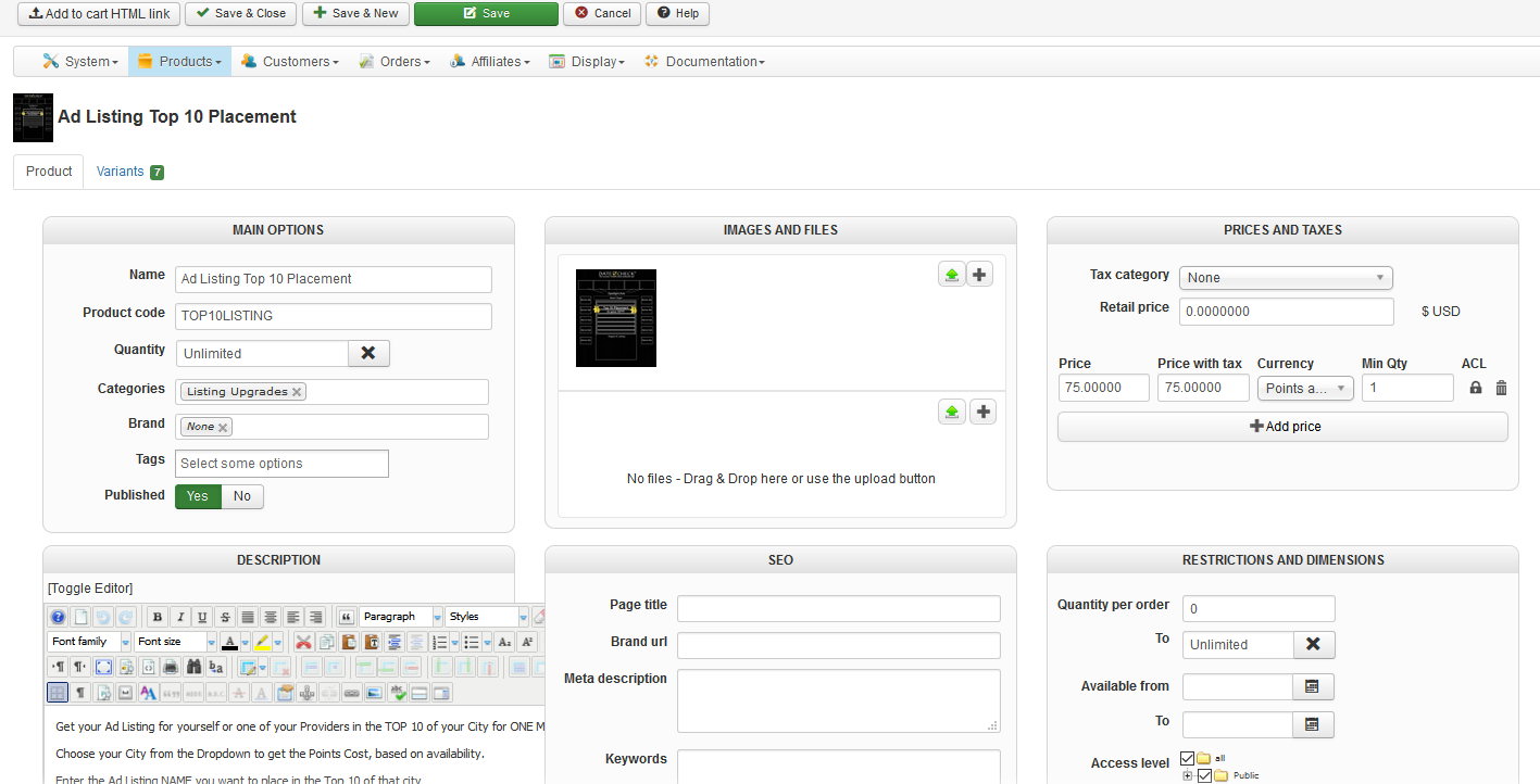

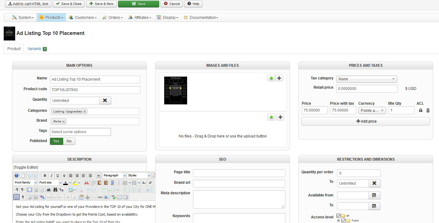

2nd is the product that has points as currency set. There are 7 variants of this product, all set to Points as currency.

  • Posts: 26387
  • Thank you received: 4078
10 years 1 month ago #247675
Nicolas wrote :
I simply told you that you can't have a points currency and base the payment methods on that as it won't work like you expect it to work. I gave you an alternative to do what you want. If you didn't understand something in the solution I provided, like me know what you didn't get and I'll be happy to explain further on that point.
Your configuration is based on the currency ; unfortunately we told you that it won't work as you want.
The currency is global in the website, so the customer can choose USD, EUR, etc.
The "user points" is there to use points in order to pay an order with. That order should have a real currency (USD, EUR, ...)
So the customer can choose the fake currency "Points" and the all store will display prices under that currency. But it will also mean that products could not have price and that HikaShop will have to convert prices from "USD" to "Points" (and vice-versa)
The "user points" system for the payment part has not been design to let you pay only for specific products.
The part which give points have such kind of features but not the payment one.
It is mostly because a payment method should be able to pay an entire order and you can't have two payment methods for one order. The "user points" payment plugin is still a payment plugin like you can use during the checkout ; maybe in the future there will be a new plugin which will only provide discounts using points but the first version of the plugin has been designed like that and we have to keep that compatibility otherwise it will break a lot of websites using it.
