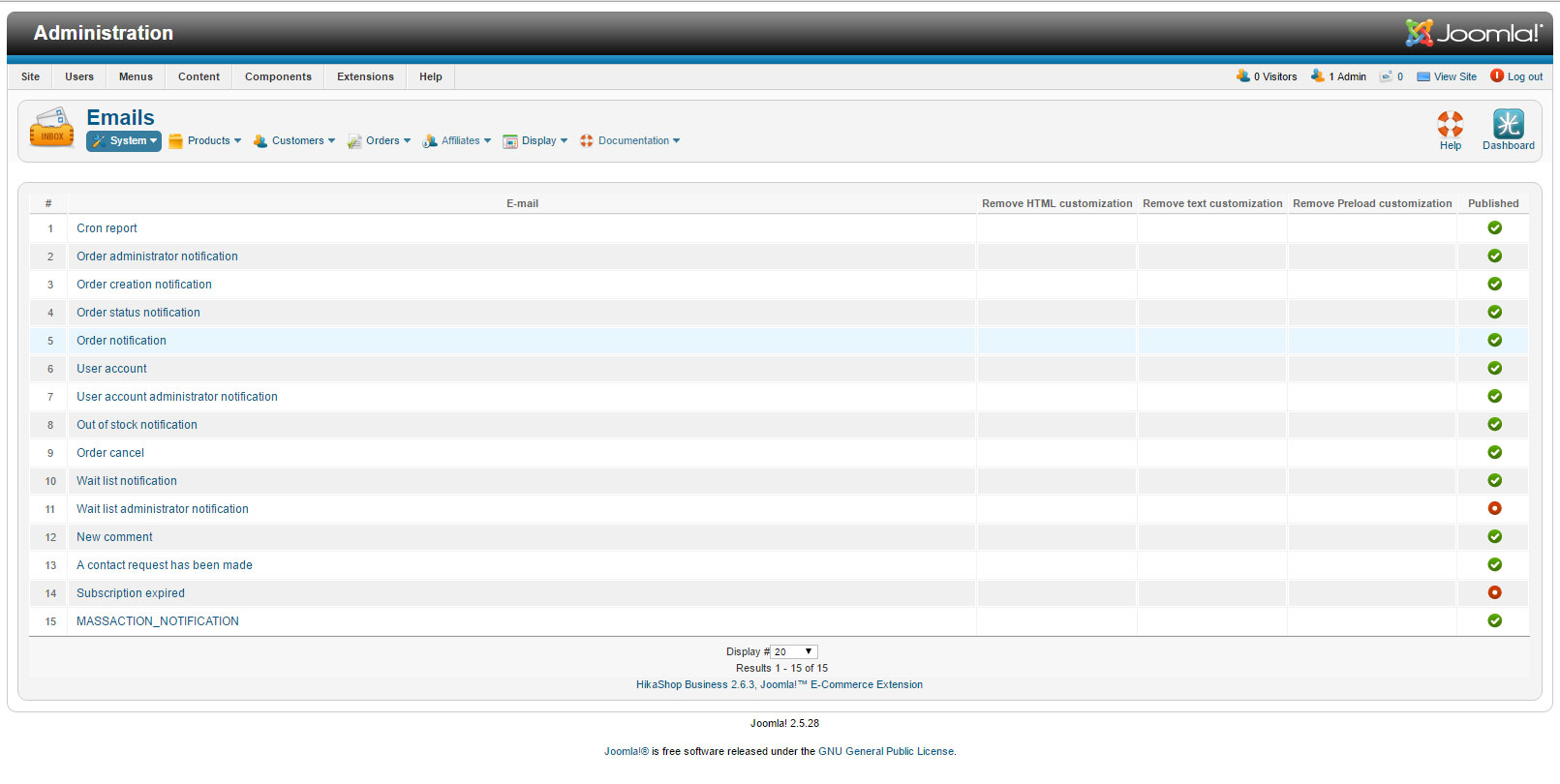

  • Posts: 44
10 years 2 months ago #245095
Hi nicolas,
They are all published bar the ones not used
I've attached a screenshot
Paul
