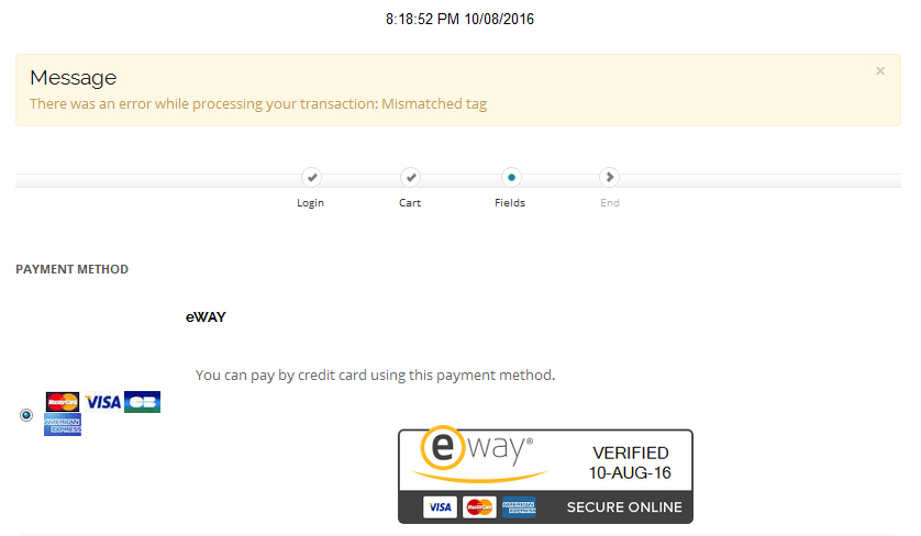

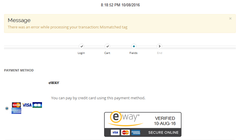

9 years 11 months ago #247339
Using - eway plug in. Error produced when "finish" control pressed. also using Akeeba "Admin tools".
Eway advise they are are not receiving any information in their system from the transaction.

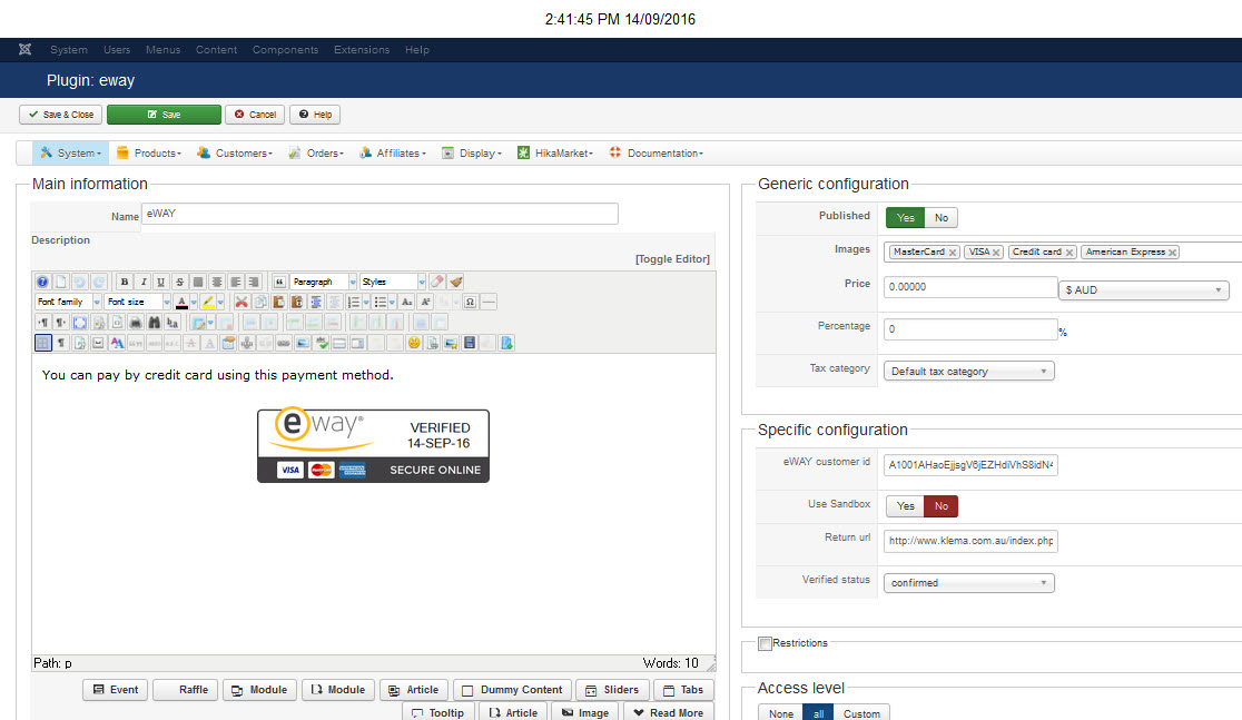

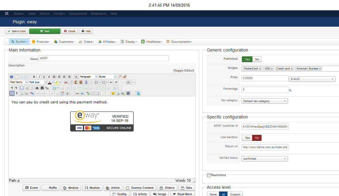

9 years 10 months ago #249771
I have attached
1. a screenshot in debug mode, there is nothing in the payment log.
2. screenshot of payment configuration
Sorry for the delay in resonding.
  • Posts: 26376
9 years 10 months ago #249803
The error message "mismatched tags" is coming from the eWay payment platform.
You should contact directly the eWay support in order to have more details about the source of that issue.
The plugin do not have errors ; it just display what the payment gateway replied.

  • Posts: 4
9 years 10 months ago #249979
Thanks for all your assistance. Eway Europe not Australia) have pointed out error in plug configuration. Should use customer ID not API.
Problem fixed.
