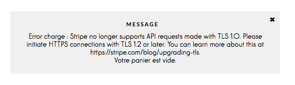

I'm trying to implement the Stripe payment plugin on this website. I've read this thread, installed the latest version of the plugin but I still get this error message : Error charge : Stripe no longer supports API requests made with TLS 1.0. Please initiate HTTPS Connections with TLS 1.2 or later. You can learn more about this at stripe.com/blog/upgrading-tls . (see

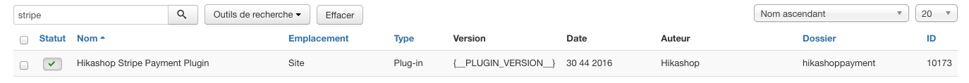

The plugin date seems a bit weird also (see )

My problem was solved by following these steps :
- installing the latest version of the plugin
- upgrading MAMP on my local server (from 3.x to 4.x), PHP 7 and new version of OpenSSL
- upgrading the PHP environment on the distant server (from legacy to stable, PHP 7)
Thanks to everyone who helped.
