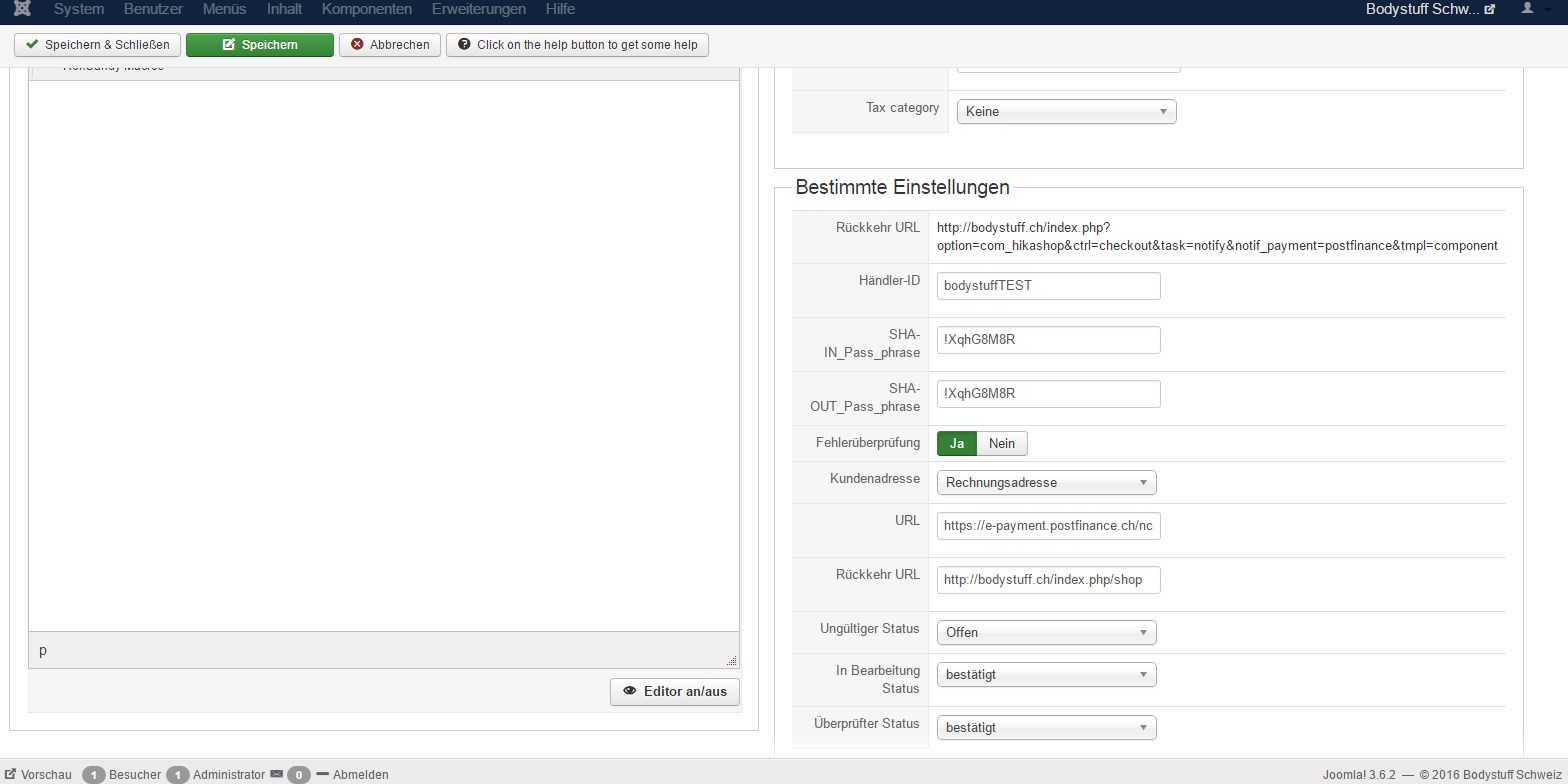

I've also attached the filled formula for the payment as screenshot.

You should have an entry in your HikaShop payment log telling you the signature is invalid.
Please check your configuration and be sure that the SHA out setting is correct (no extra space, etc).
