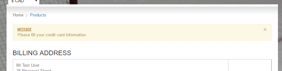

About to go live with a site and was testing and discovered an issue with checkout/payment. When I click "Finish" on the checkout page, I get a message that says "Please fill your credit card information" when I have chosen the credit card payment (Hikashop Credit card). I never see the credit card form to fill out. I have tried disabling shipping options and creating new payment method with Hikashop Credit card.

I would say that it's probably a javascript error on the page preventing HikaShop from displaying the credit card form.
Could you provide a link to the shop and the steps to reproduce in order to analyze the situation ?

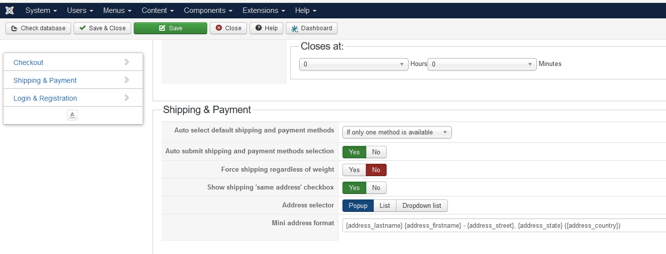

It's seems to be related to the "auto submit shipping and payment methods selection" setting being turned off in the HikaShop configuration of your website.
Try turning on that option and it should help.

I turned on the "auto submit shipping and payment methods selection" option and stil have no luck. see screen shots.
What else can be checked?

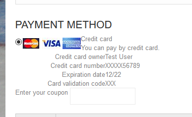

Now that I see the cc form, how do I change the number of digits? It only lets me put in 9 digits when most cards are 16 digits. Also, on the confirmation page of the checkout. the ccinfo is not formated properly. see attached picture.
Thanks in advance.

2. I don't see the problem ? Besides the fact that you could a bit improve the display with CSS code the display looks valid.
