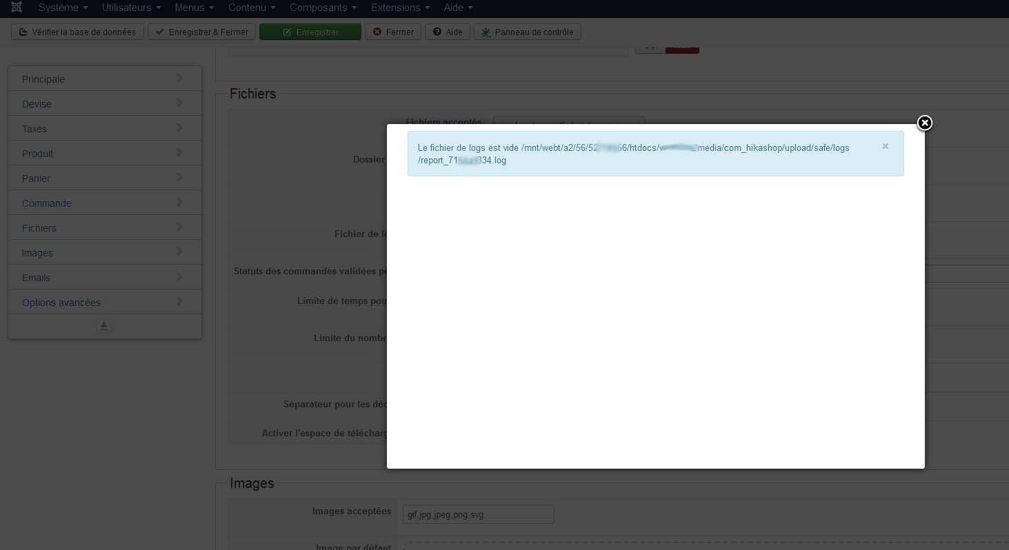

The pb is that my Paypal log file is empty !
Here from the HS config :

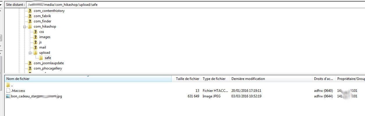

And here from the ftp :

The pb came back yesterday, I desintall Admintools and...I see on my ftp root an .htaccess.admintools, can it be a source of my pb?

9 years 10 months ago #255729
The htaccess on your root could be problematic yes, but not the one in the safe folder that you have in your screenshot.
Also, I invite you to check the points and follow this documentation:
www.hikashop.com/support/documentation/i...or.html#notification
It should help you find the root of the problem.
