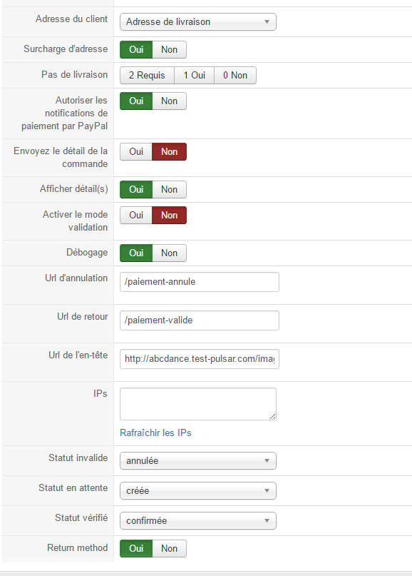

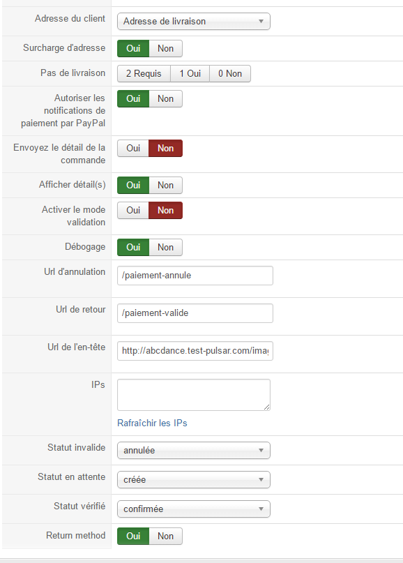

Bonjour à tous :)
Voilà, j'ai bien relié mon site au bac à sable de paypal, les notifications emails marchent bien, mais au retour de la transaction, la commande créée reste en mode "créée" et n'est pas passée en "confirmée"
Dois je faire à la main le passage de status à "confirmée" ? en remplissant une url retour serveur/serveur ?
Pourtant j'ai bien rempli les options dans la config du plugin paypal :
statut invalide : "annulée"
statut en attente : "créée"
statut vérifié : "confirmée"
Je ne comprends pas ce qui cloche... help please ?
Merci :)
Joachim

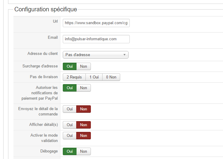

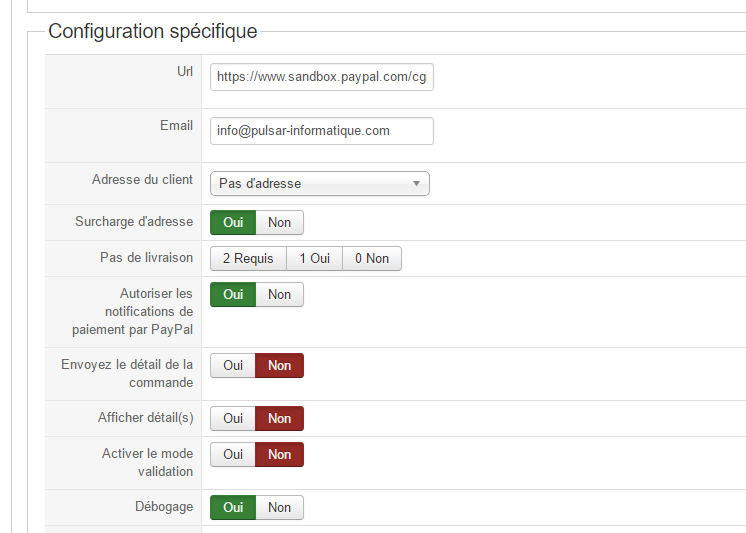

Ok, now, the log file is created \o/ - the config hikashop wasn't good :) i see it when i was reading the code :)
All work perfectly when i cancel an order on the paypal page : the order status is automatically "cancel"
BUT when i pay the order (on the sandbox paypal) the order status still "Pending" - but on the sandbox it's write "you've successfully paid"
and when i see the log file i see this :

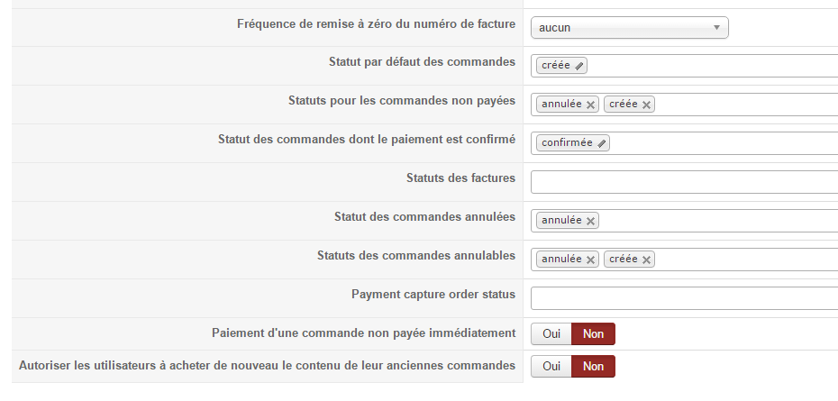

ps : there is my config
Joachim
Last edit: 9 years 9 months ago by pulsarinformatique.
  • Posts: 86181
9 years 9 months ago #256314
As the log says, the payment notification received by HikaShop says that the payment is pending.
This means that you have the "enable validation mode" setting activated in your payment method settings page and because of that, the payments are not automatically validated when they are made. You need to validate them manually.
That's the most common reason.

  • Posts: 202
9 years 9 months ago #256358
Hie, thanks to answer :)
just to be sure, my config is good now ?
