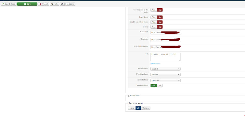

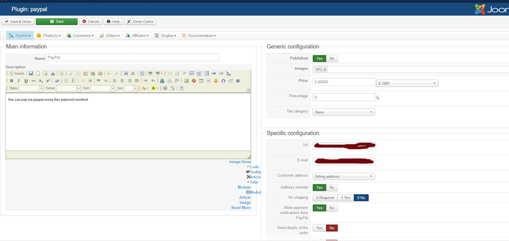

I don't see why the payment notifications would be received for some countries and not for others.
So how did you configure your payment methods ? (could you do a screenshot) ?
Are they all using the same payment method ?
Are you able to reproduce the problem yourself ?
Did you get something in the "history" of the orders without the status change ?
If you turn on the debug setting of the payment method, it should add debug data in the payment log file of the HikaShop configuration after each payment. Do you get anything there for the orders without the status change ? What do you get ?

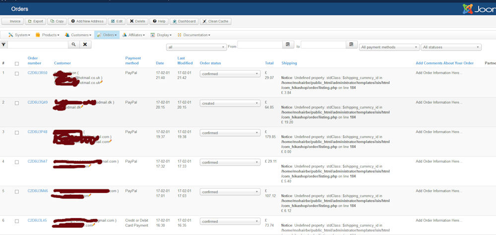

PayPal screen dumps attached
Attached is a screen dump of orders after my first post. You can see the 'created' one and this is from Denmark, payment has been received, all the rest are UK orders that have correctly changed to 'confirmed'
thanks

The payment log file is available in the HikaShop configuration under the files section.
Also, if the IPN notification failed for an order you might be able to get some useful information from the IPN history in your PayPal merchant account. So I would recommend to check there to.
I'm not sure why you say you can't reproduce it because it works for UK payments ? Can't you just change the country of your address during the checkout in order to check for other countries ? You could make a payment of 1 £ for your test for example.

You will find the debug mode for Paypal in his backend configuration, Specific configuration part.
See this tutorial for your Paypal plugin AND this one for payment log.
