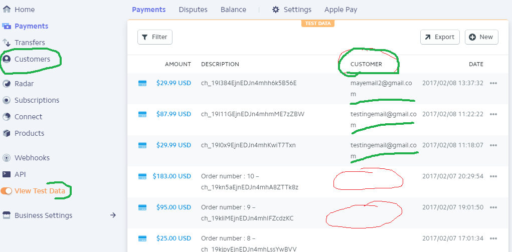

Test works well , except that user data such as Name and Email does not show in Stripe account after successful payment done. It does not passed to stripe.
I used stripe in the past and it was working well and passed user name and email. Wot is wrong now?
Please help to fix the problem.

Correct, Hikashop Stripe plugin is INCOMPLETE because when Hikashop processing information to Stripe it does not pass email and as a result Stripe fail to create a CUSTOMER record. And Hikashop has this Stripe plugin not fixed for years. So you are correct, it never passed information to create CUSTOMER record on the Stripe.
YOU ASKED : Would this difference come from a merchant account setting requesting it on stripe's end or something ?
THE ANSWER: not at all. The difference comes from the plugin and not from merchant account setting.
No customer record and no history for that person created on the Stripe as a result of HikaShop plugin. Stripe use that email record to send emails to the customer and also make possible to ad subscription plan from the stripe admin.

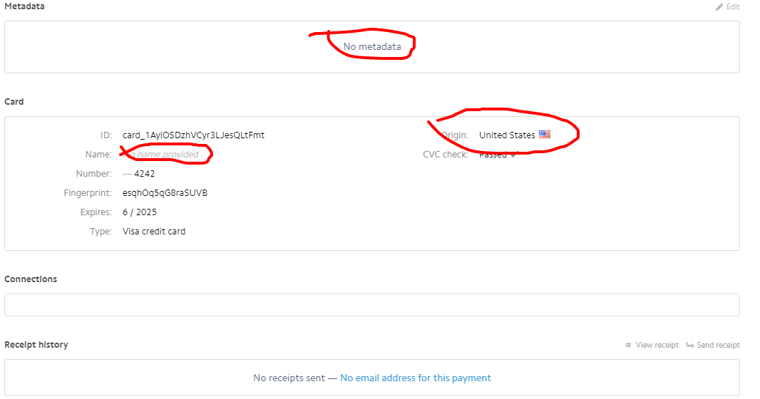

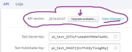

Second, STRIPE have NEW API not reversable version of API and it is a good time to Update Stripe plugin for new API they have
Please see image 2
and reference: stripe.com/docs/upgrades?since=2016-03-07#api-changelog

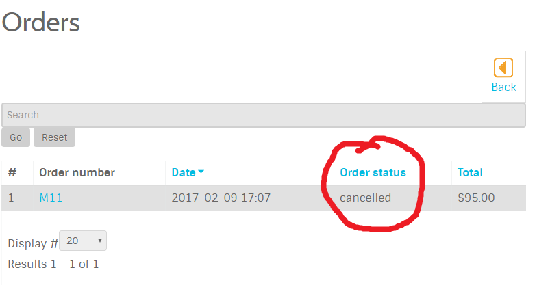

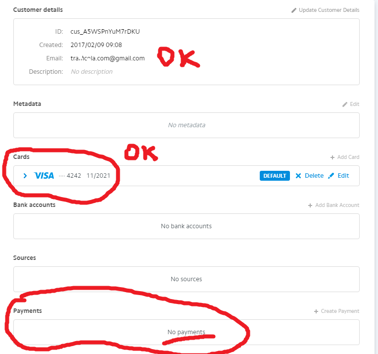

  • Posts: 132
9 years 5 months ago #261851

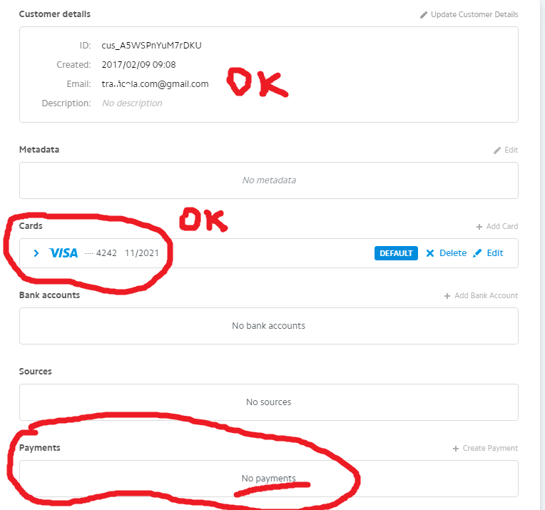

I appreciate you taking care of this plugin and upon my test i have got mixed result:
1) STRIPE ACCOUNT:
- Stripe created the customer record - that is a good news.
- No Payment - Payment Status is missed and there were NO Payment made - that is a bad news
2) MY WEBSITE - User account control panel/ ORDERS
- product Order Status is cancelled
3) Here is the admin message immediately after payment:
Error charge : Unknown column 'id' in 'field list' SQL=UPDATE `#__hikashop_user` SET `user_cms_id`='428',`user_email`=emailofthetester@gmail.com',`user_partner_email`='',`user_params`='O:8:\"stdClass\":1:{s:18:\"stripe_customer_id\";s:18:\"cus_A5WSPnYuM7rDKU\";}',`user_partner_id`='0',`user_partner_price`='0.00000',`user_partner_paid`='0',`user_created_ip`='159.83.252.234',`user_unpaid_amount`='0.00000',`user_partner_currency_id`='0',`user_created`='1486589850',`user_partner_activated`='0',`id`='428',`name`='Ttraffol',`username`='traff',`email`='emailoftheteste@gmail.com',`password`='$2y$10$NZNAUQR3oNH76dTcxPcvCOH7VgNhXc/0M89iW33nExq4A5RC2z2dm',`block`='0',`sendEmail`='0',`registerDate`='2017-02-08 21:37:30',`lastvisitDate`='2017-02-09 17:06:08',`activation`='',`params`='{\"admin_style\":\"\",\"admin_language\":\"\",\"language\":\"\",\"editor\":\"\",\"helpsite\":\"\",\"timezone\":\"\"}',`lastResetTime`='0000-00-00 00:00:00',`resetCount`='0',`otpKey`='',`otep`='',`requireReset`='0' WHERE `user_id`='9'
Thank you again for your attention to this payment plugin. Please advise or fix.
Looking Forward. Thank you.
Website Order Status:
Last edit: 9 years 5 months ago by alexmartin.
