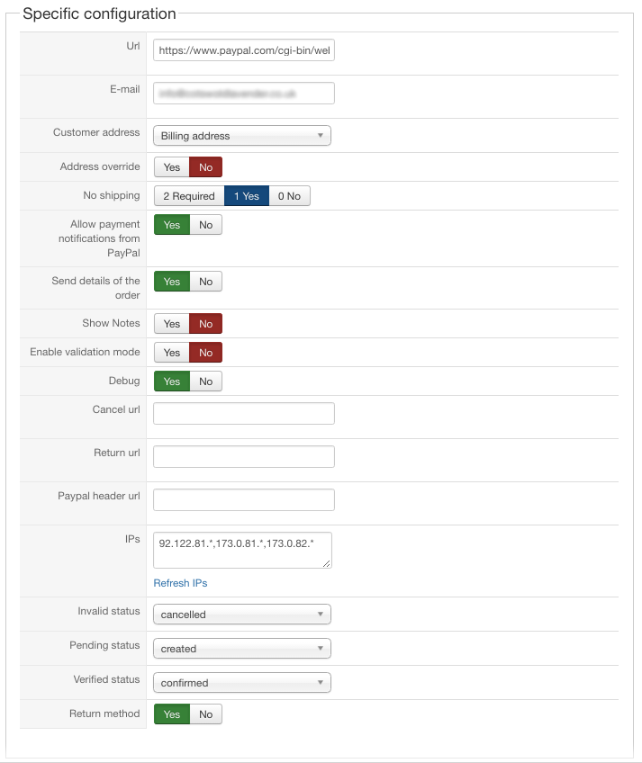

-- Joomla version -- : 3.6.5
I have the standard PayPal plugin setup within Hikashop, with the settings as in the attached image.
When I created an order via the website, I was transferred to PayPal, processed the transaction successfully and then returned to the site, whereby I got the confirmation screen saying my order was successful and I would receive an email notification. I can login to my HikaShop account and see the successful order and have received an email from PayPal saying my order was successful.
However, I have not had the HikaShop customer order notification email. I do get this email when using the WorldPay payment option but not when using the PayPal option.
What have a I done wrong?

  • Posts: 237
  • Thank you received: 5
9 years 7 months ago #262294
I have done everything on this page www.hikashop.com/support/documentation/i...nt-paypal-error.html
There are no errors in the log file, the server reports a successful 200 status.

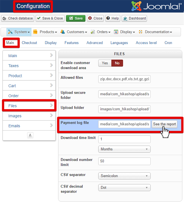

9 years 7 months ago #262315
Can you check that order status is mute to confirmed by ¨Paypal payment plugin ?
Do you process some test with the debug mode On in paypal plugin configuration ?
And have a look on the payment log ( in Components => HikaShop => Configuration and file part)
Can you provide complete log file in order to see if we have some clues on what's going on ?
For this use our Contact us form, and fill your message subject with this topic subject.
Awaiting news from you.
