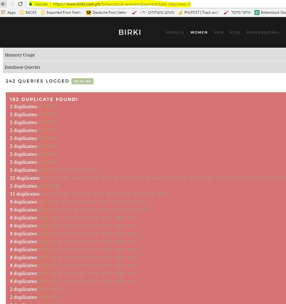

  • Posts: 108
9 years 6 months ago #264955
yes, when I switch to protostar it's working.
I tried to debug with enabling the Joomla debug message, when I do that it's working again and I cannot reproduce the problem.
However, there are many red comments showing as errors, I'm not sure how to handle it, they call it database duplication.
Please see attached.
Thank you
