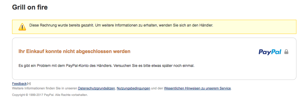

If you make paypal for pay and you click "order" you will switch to paypal with an Error page I attached.

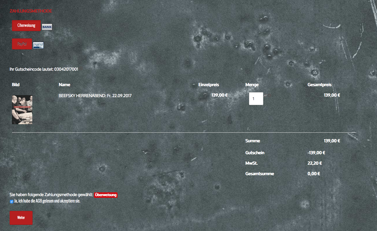

If i fill out coupon code and the price is 0.- and I click on order, I was taken to the bank transfer payment or to paypal payment but it is 0,- so I didn`t need it.
If I have 0,- to pay Iand click order I must taken to a thank you page or something like that because i didn`t need to pay a balance.

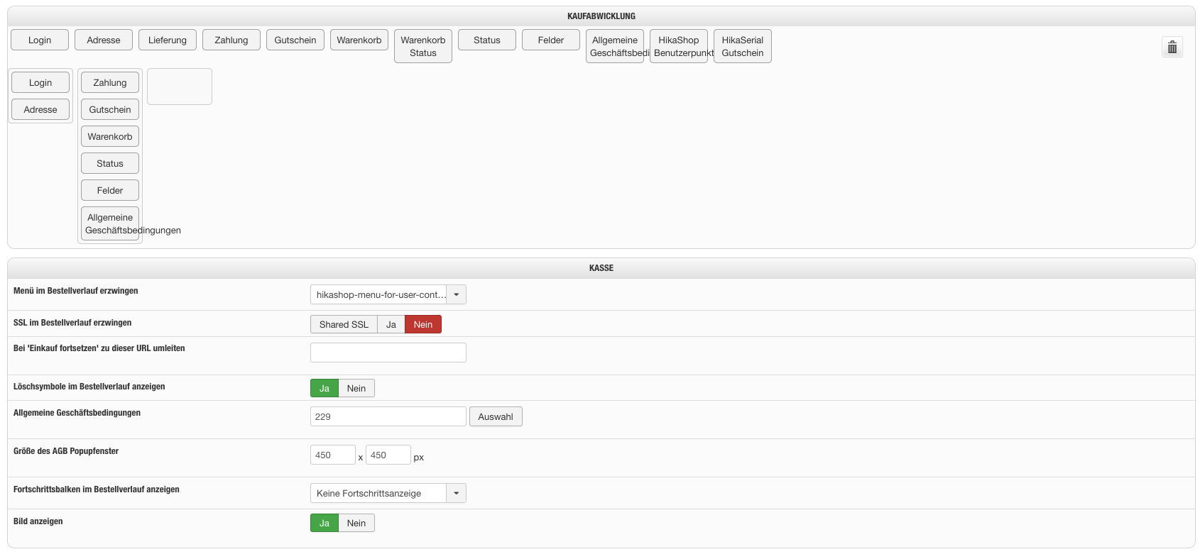

  • Posts: 4
9 years 4 months ago #269831
You can see my settings in attachment.
If I fill out a 100% discount but the payment method selection isnt removed so I was link to bank transfer payment or to paypal payment
  • Posts: 86217
  • Thank you received: 14222
9 years 4 months ago #269837
You didn't provide a link to the shop or instructions to reproduce the problem, and the screenshot you provided is in German, which we don't speak and doesn't contain all the settings under the checkout tab.
So I'm not able to say anything more than what I already wrote in my previous message. Could you provide the information we need to be able to help you ?

9 years 4 months ago #269990
grillonfire.seiler-kunz.de
This is a testside so you can make an oder to check it.
If you oder e.g. "BEEFSKY HERRENABEND" and make Coupon-Code "03042017001" inside you have to pay 0,-.
9 years 4 months ago #269998
I just processed some test on your website, and I can see that there is something strange, now what's the root of this issue ?
In order to go forward can you :
- Test this with a default template like (ProtoStar), if that solve, issue is in your override view.
- Provide payment method configuration WITH restrictions part (if you have define some of them).
- Process same test in Legacy checkout AND new checkout, see if results are different ?
Awaiting news from you, with precise elements return.
