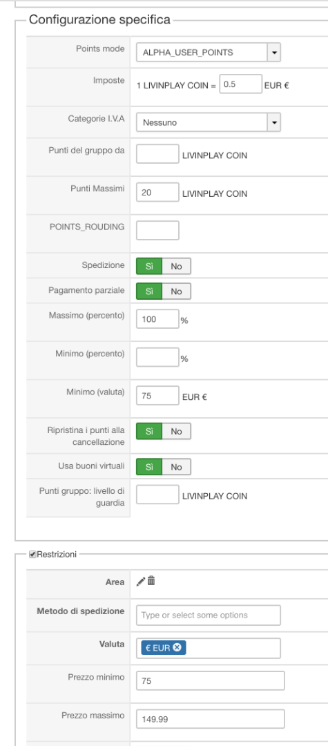

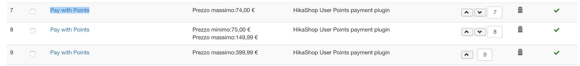

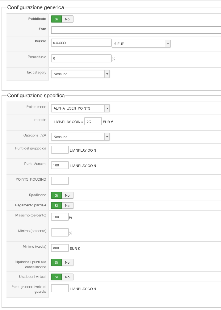

we’re facing issues to make the “Pay with points” method working as we want:
we need to make possible to our users to use “x” points (from alpha user points) for an order that is under a certain “total price” (e.g. 100€), when the total price is 101 we need to make possible to our users to use “x+n” points, and so on for some “blocks” of “total price” values…
actually we tried to set restrictions with a minimum and maximum value of the order, but in the checkout we always have the “first block of points” usable from our users and the pay with points method is not replaced properly,

  • Posts: 12
9 years 3 months ago #272242
i tried to turn off the coupon mode and i see that the pay with points method behaviour is a bit tricky for costumers (that can have issues selecting more than one time the same payment method during the checkout process),
so i tried also to remove the amount restriction and i tried to manage the different 'points payment methods' changing only the minimum value field, but the points of all the maching methods doesn't cumulate the points, but the first points payment method is used, and only the Maximum points set into the first method is calculated in the cart.
unfortunately i wasn't able to find a solution managing the plugin and i think that we're going to customize the plugin, but there is something that maybe we're not setting properly to make the system works as it is now?
