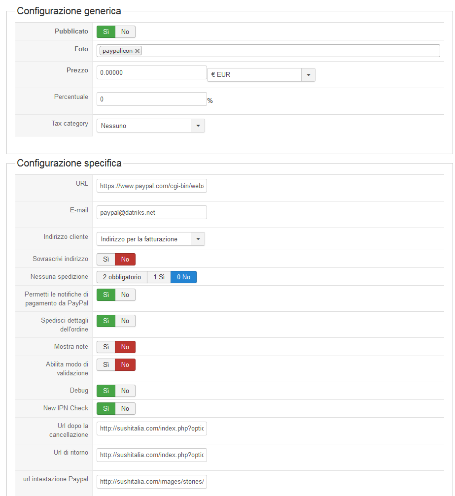

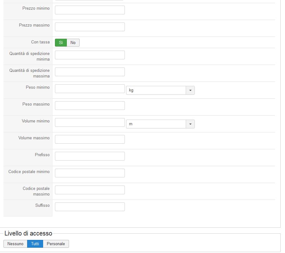

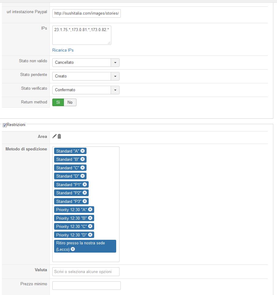

Please provide a screenshot of your paypal method configuration.
  • Posts: 56
8 years 11 months ago #276107
Hi Jerome,
see the attached screenshots
Last edit: 8 years 11 months ago by trik84.
  • Posts: 26376
8 years 11 months ago #276111
I see that you send the cart details.
So there are possibilities that your issue is coming from the UTF8 encoding.

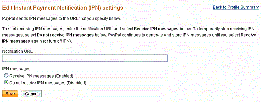

If i see my IPN history page in PayPal i see all notification before 02/08 have status failed, and all after have status disabled, on 02/08 I've installed new plugin and active tne option New IPN Check.
In PayPal IPN configuration setting the option Not recive IPN messages (disabled) is flaged, to enable the IPN notification this option must be active ?
I've never modified this option but befote the update to the last hika shop version all works fine.
