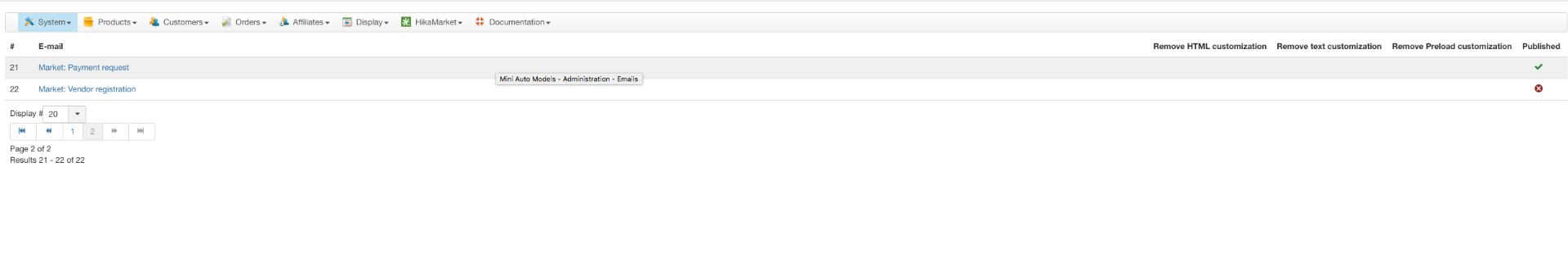

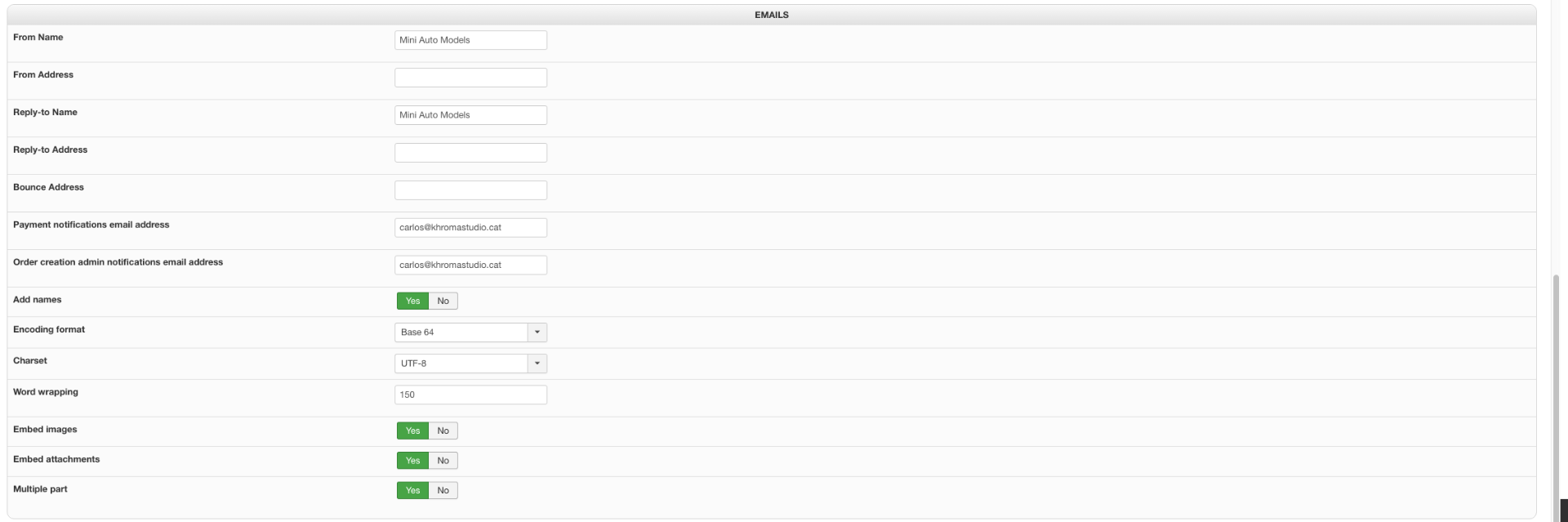

I have an email to be sent to the administrator of the website when an order is paid.
But it's not sending. I don't know what I have done wrong in the configuration.
The other mails work fine.
I attach the mail configuration.

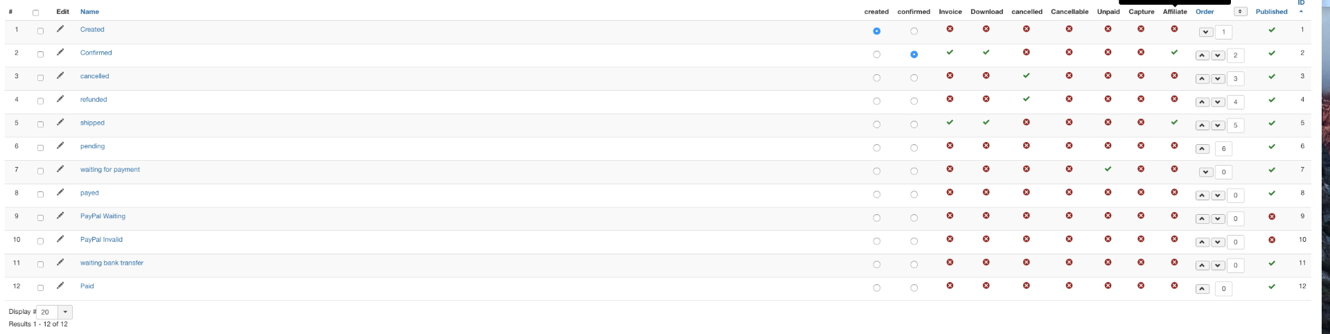

8 years 10 months ago #278853
I see that you create a status "payed" (maybe you meant "paid" ?), but how do you configure it ? Can you provide your Statuses listing ?
Awaiting news from you

8 years 10 months ago #278909
I attached the configuration you request me

8 years 10 months ago #278921
A payment notification email is sent when the payment plugin receives a payment notification HTTP request from the payment gateway where the payment happened to notify it that the payment has been done.
The "collect on delivery" payment plugin doesn't redirect the customer to any payment gateway for the payment since the payment happens "offline", and thus it doesn't get any notification from any payment gateway, and thus there is no payment notification email sent, that's normal and how it is supposed to be.

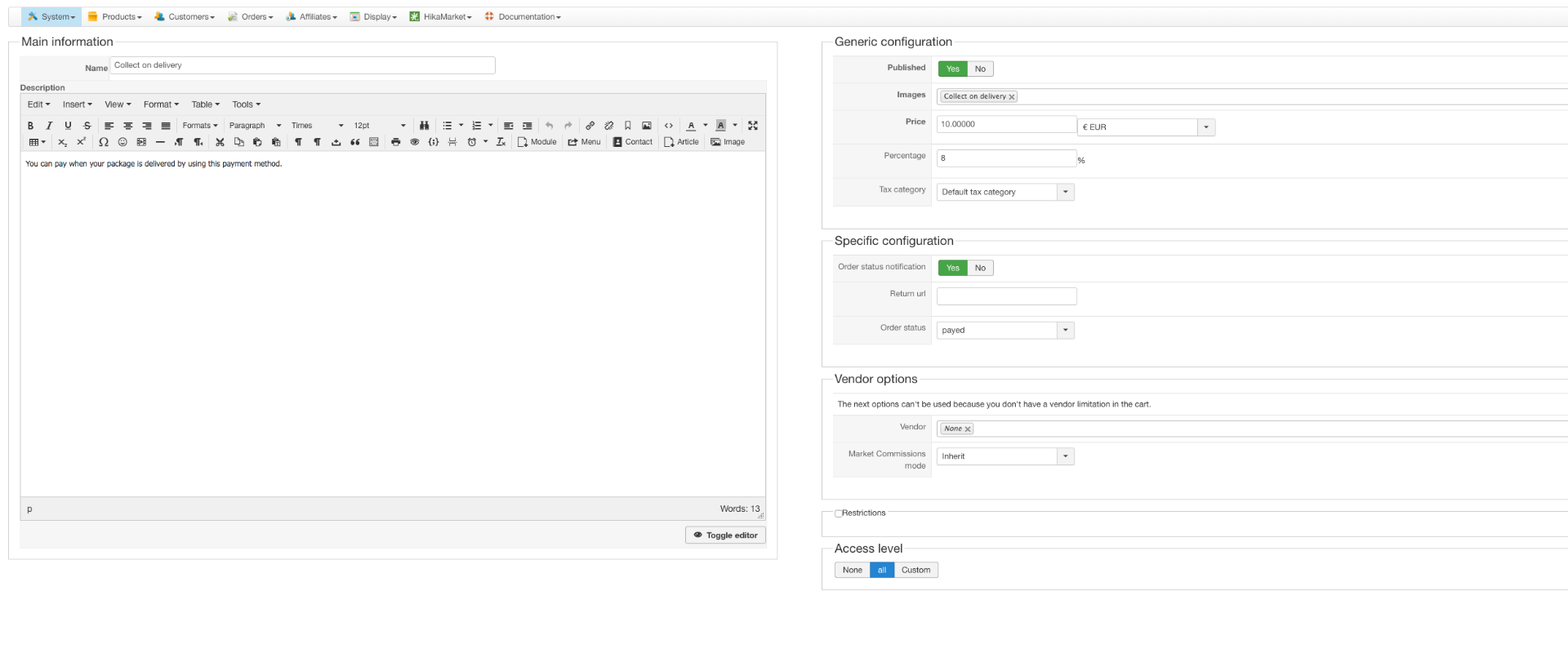

8 years 10 months ago #279078
I configure my shop to allow the payment method to be chosen after vendor confirms that the package is ready to ship,
then,
The client receives an email requiring him to choose a payment method
He logs in his account and chooses a method
Then if the method that the user chose is an instant payment method (paypal, credit card) the vendor will recieve a notification once the payment is succesful.
And if the method is not an inmediate one (Collect on Delivery) then no email is sent to vendor to let him know that a payment method has been chosen.
MY QUESTION IS:
How can we send an email notification to let the Vendor know that the client has chosen a payment method that requires the order to be delivered (Collect on delivery)
Carlos Bayo
