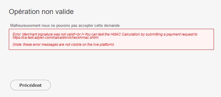

  • Posts: 6
8 years 9 months ago #283533
Hi Philippe,
sorry to reactivate this post but I've faced same problem with no success.
I've asked Adyen support that has switched encryption level to SHA1 but I get the same error.
My tries
1 - I've modified adyen.php file (sha256 rather than sha1) but but no success as well. So, I use the original file now.

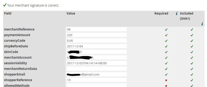

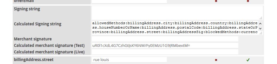

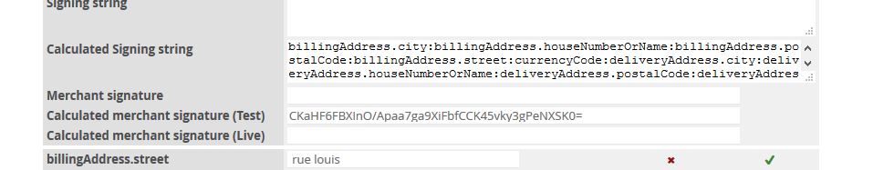

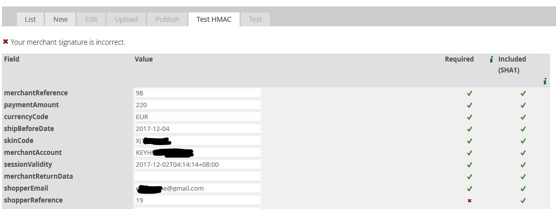

2 - I've tried the test URL: ca-test.adyen.com/ca/ca/skin/checkhmac.shtml and I see the right data (i.e. the parameters of the payment plugin). BUT, the answer of Adyen is "Your merchant signature is incorrect" (see picture).
If I click on the "Test HMAC" button without changing anything, the answer is Your merchant signature is correct (see picture).
The only change is the "Calculated Merchant Signature" which is different (see picture before and after).
That means hikashop plugin does not calculate in a proper way?
Last point: the changelog of Adyen Version 2.2.0
Add Adyen::HPP to integrate with Adyen's Hosted Payment Pages. Adyen::HPP supports the new HMAC-256 signing mechanism. Adyen::Form should be considered deprecated and will be removed from a future release.
Maybe an update of the Adyen plugin could be a good option...
Thanks in advance for your help.
Last edit: 8 years 9 months ago by evirvaux. Reason: Add a precise explanation of the difference between before and after having click on "Test HMAC" button.
