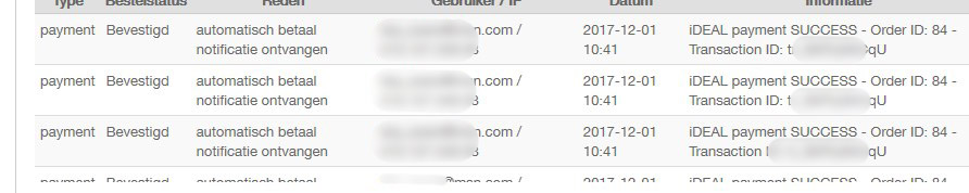

I have a strange problem with the order confirmation e-mails.
When the order is paid the Mollie (Dutch ideal payment provider)sometimes sends out double and sometimes up to 8 confirmations of the payment.
This results in sending out up to 8 confirmation e-mails to the shop owner as well to the customer.
This is at random, sometimes all is working correct with just one confirmation.
Is there a setting that i have overlooked?
Is the ideal plugin the problem?
Is there something wrong in the setting of the hosting?
I don't think the payment provider is the problem because i'm running mollie and Hikashop on another website without any problem.

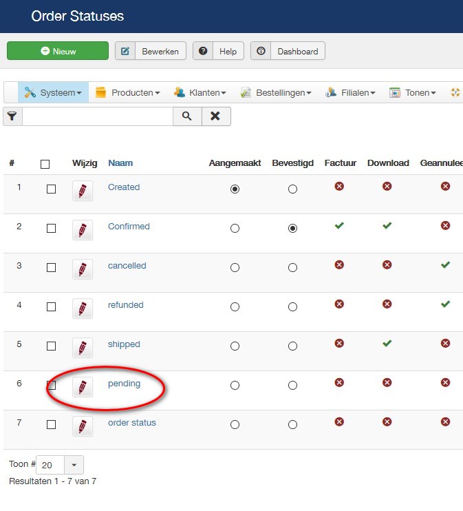

8 years 9 months ago #284431
Hello nicolas,
I have an item in "order statuses" called pending published could that be the problem why the payment plugin keeps asking for the payment status?
In another Hikashop i've build I don't have a status called pending.
  • Posts: 86217
  • Thank you received: 14222
8 years 9 months ago #284443
That's one of the default order statuses.
It's not used by default though.
It was added long ago on our end, but if you updated from a version from before that, you wouldn't get that status.
But in any case, that also doesn't have any link with the emails being duplicated.
As I said previously, all I can think is that some modification in the plugin would be necessary to prevent that glitch from happening.
