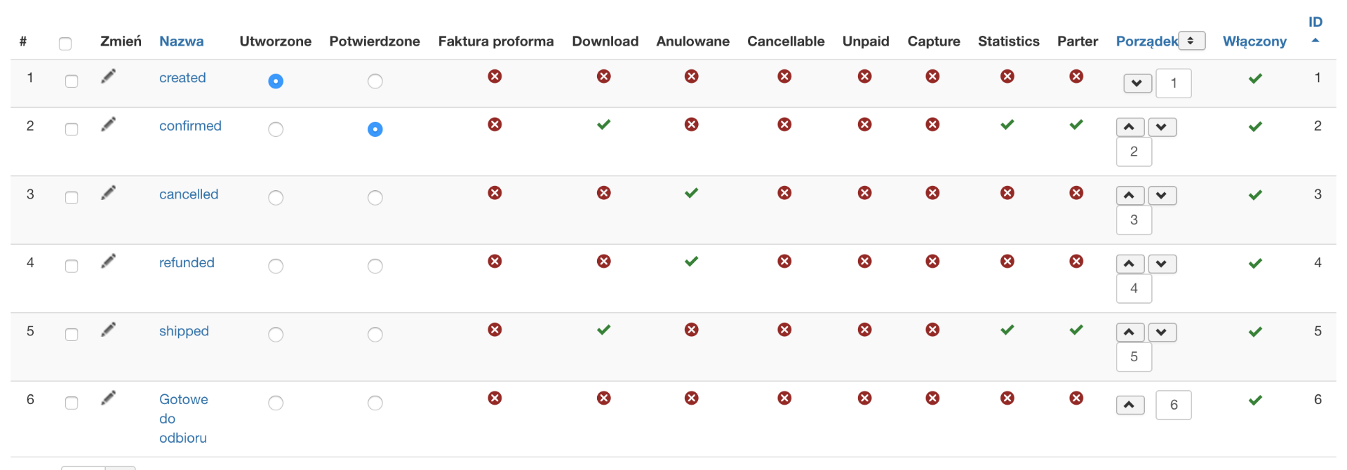

8 years 3 months ago #293646
Configuration as on the annex. Initially it worked correctly.

8 years 3 months ago #293663
I suppose that you must have the "give back points on cancellation" setting activated in the payment user points plugin.
In that case, you need to enable the order statuses confirmed, shipped, etc for which the points are not taken under the "invoice" column of the System>Order statuses screen.

8 years 3 months ago #293708
The suggested solution did not work. I checked the configuration of the Hikashop UserPoints Plugin again. The Valid order statuses option was set to "confirmed". I deleted this record. Now points are charged when you change your status to sent. It's working right now. However, the observation shows that previously it worked differently because customers were charged points.
