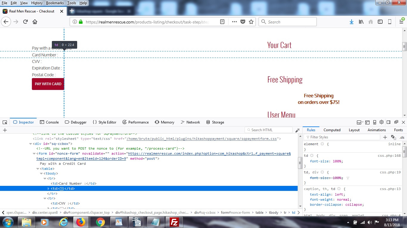

Plugin successfully installed on HikaShop Starter: 3.5.1. but dead check-out dead ends on payment page.
The ID, Token and Location information has been entered. However the form does not have input fields to gather the information; please see screen shot.
The installed version of the plugin was re-downloaded today 8/13/18.
I am assuming the plugin works with the Starter so what am I missing? All check out, cart and payment template customization has been removed.

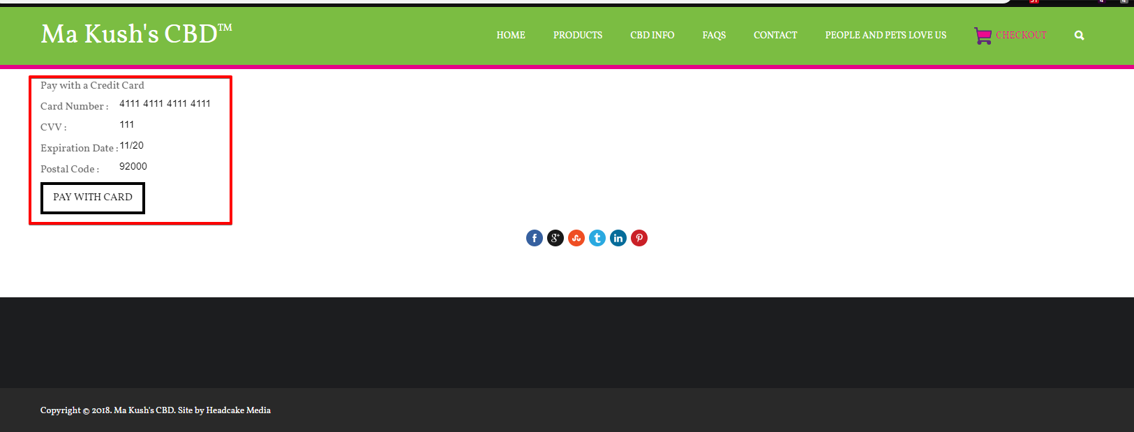

  • Posts: 25
7 years 11 months ago #298668
I disabled the postal code requirement and now there is default text in the fields, but they are still not editable. See attachment. I will send you a PM for access to the back end.

  • Posts: 25
7 years 11 months ago #298716
I installed the updated app and I can enter information now. I think I may have been just typing in random keys before, and the only information the fields accept is numbers. Typing letters shows nothing.

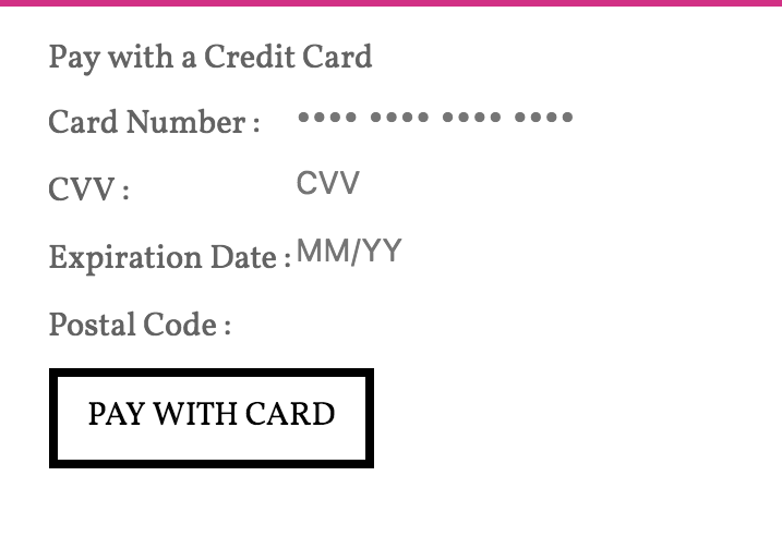

  • Posts: 9
7 years 5 months ago #305097
Frustrated here. Just purchased and installed the plugin today. I cannot see the fields or enter any information in them. Whether I change the settings for the postal code to show or not, it always shows the postal code. In one instance the fields are blank and the other there are place holders in the fields. Either way I cannot enter any information.
