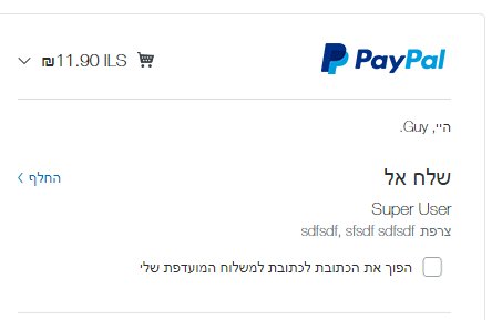

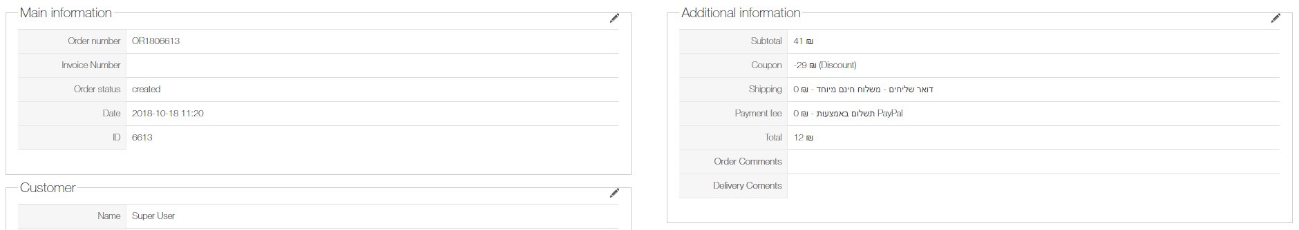

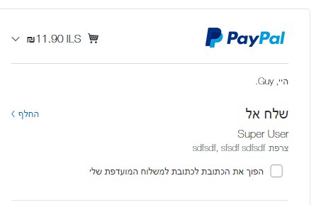

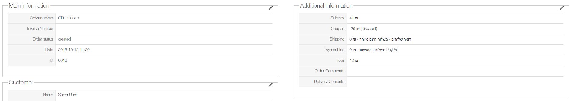

Let's say we have a product which costs $8. If I set a 30% discount the cost will be 5.6. The system will round this to $6. But, on the payment page, credit card of PayPal, the amount which is sent is $5.6. A user pays, the payment goes through Hikashop thinks that the order was no payed in full and the status does not change.
I've attached three images:
1. Rounded_discounted_price - A product which costs $17. After discount the price should be $11.9. The system rounds it up to $12.
2. PayPal_Amount - The amount PayPal expects the user to pay. This is the same when we try to pay with credit card.
3. Order_amount - The amount as it was set in the order by Hikashop.
As long as the amount sent to PayPal or credit card does not match the amount set in the order, the status will never change to approve.

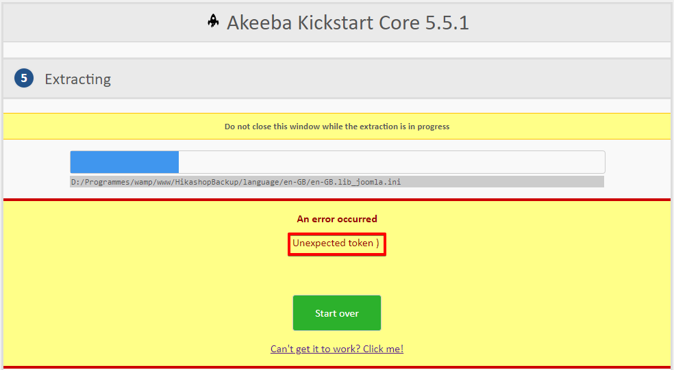

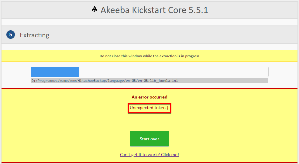

We just tried to restore the backup you sent us using the akeeba kickstart but we are having the following error message while restoring it (cf. screenshot) : "Unexpected token )"
Can you eventually send us access to an online copy of your website so that we can directly debug and fix it on your end as we are unable to properly reproduce it on our end ? Thank you.
