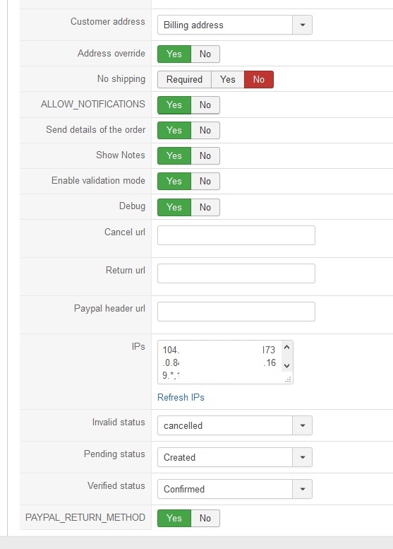

The payment log indicates that the transaction notification was received properly by the PayPal payment plugin.
If your order is still with the "created" status, then I can only think that you have that status selected instead of the "confirmed" status in the "verified status" setting of the PayPal payment method under the System>Payment methods menu.
Please check on that.

You have the "enable validation mode" activated.
This means that the payment will only be validated by PayPal after you accept it in your PayPal merchant account.
So before that, the payment_status is "pending" and thus the order is not confirmed.
If you don't have to have to validate the payments in your merchant account, you want to turn off that option.

7 years 9 months ago #299083
Disabling Validation Mode made it work correctly.

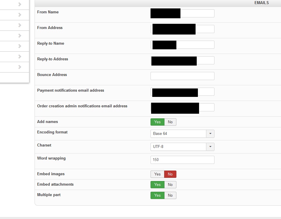

The one last issue I'm having is that I need the registrations info emailed to the same email I have set for the payment notifications. Is this possible? I have the alternate email I want these sent to set in config:

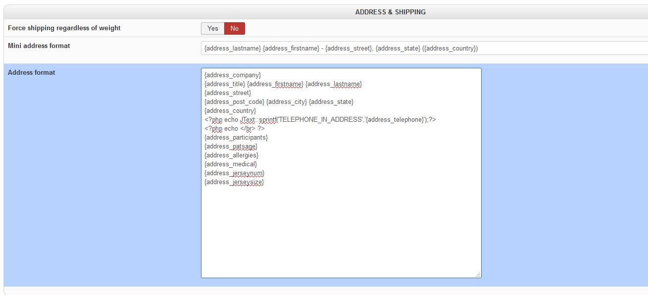

How did you add those fields ? I suppose that you created custom fields of the table "address" via the menu Display>Custom fields.
In that case, you want to add their corresponding tag to the "address format" setting of the HikaShop configuration and they will appear with the rest of the billing address in the notification emails.

Actually, I think I found it:
Just want to make sure that is where you were referring to, and that the code is correct...
(I'm assuming you can use regular php inside of it?)

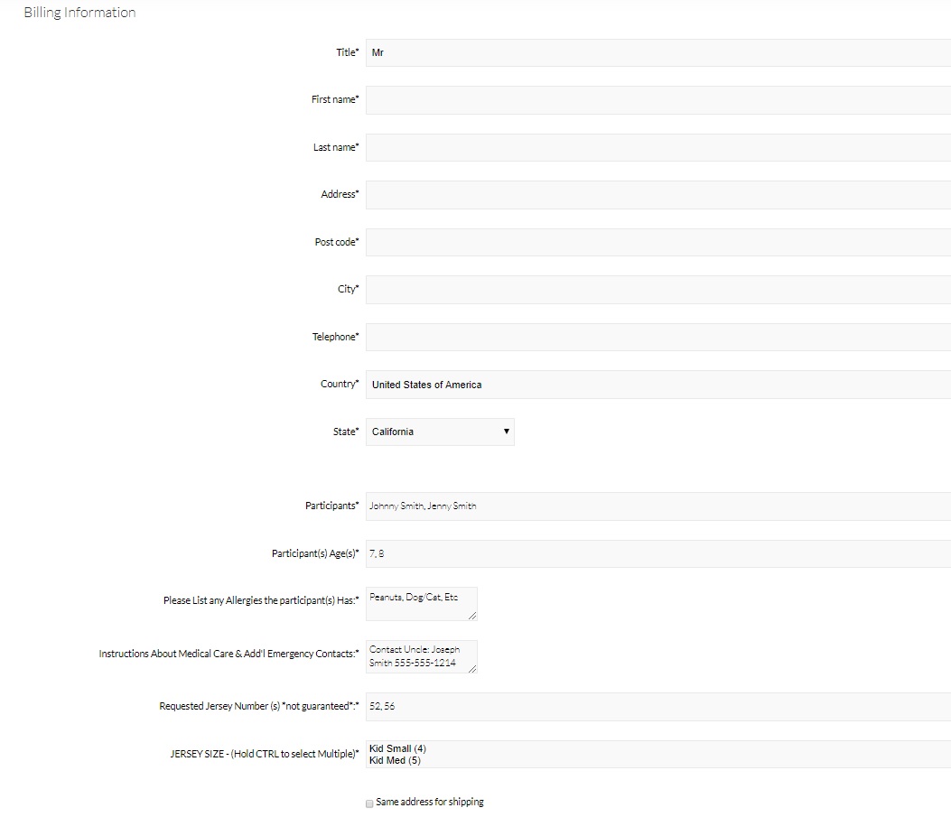

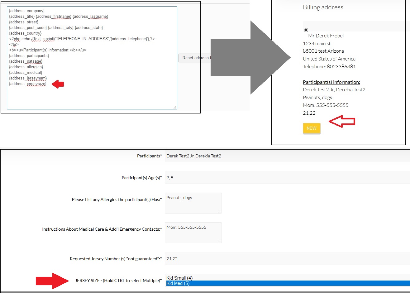

Here's the final issue I'm having:
One of the fields (address_jerseysize) is not showing up...
It's a multiple select field, so I'm wondering if that is causing the issue?
Here's an image to illustrate the issue from the 3 different pages:

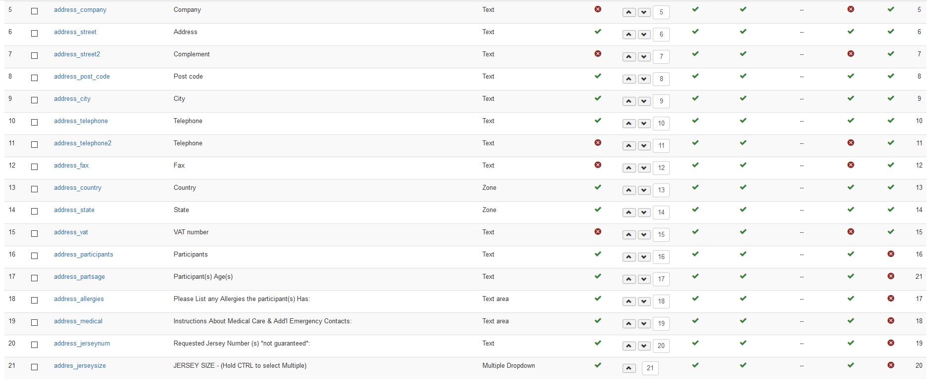

  • Posts: 85952
  • Thank you received: 14142
7 years 9 months ago #299175
It has nothing to do with the type of the custom field. The issue is that you made a typo.
Your custom field column name is addres_jerseysize and not address_jerseysize :
