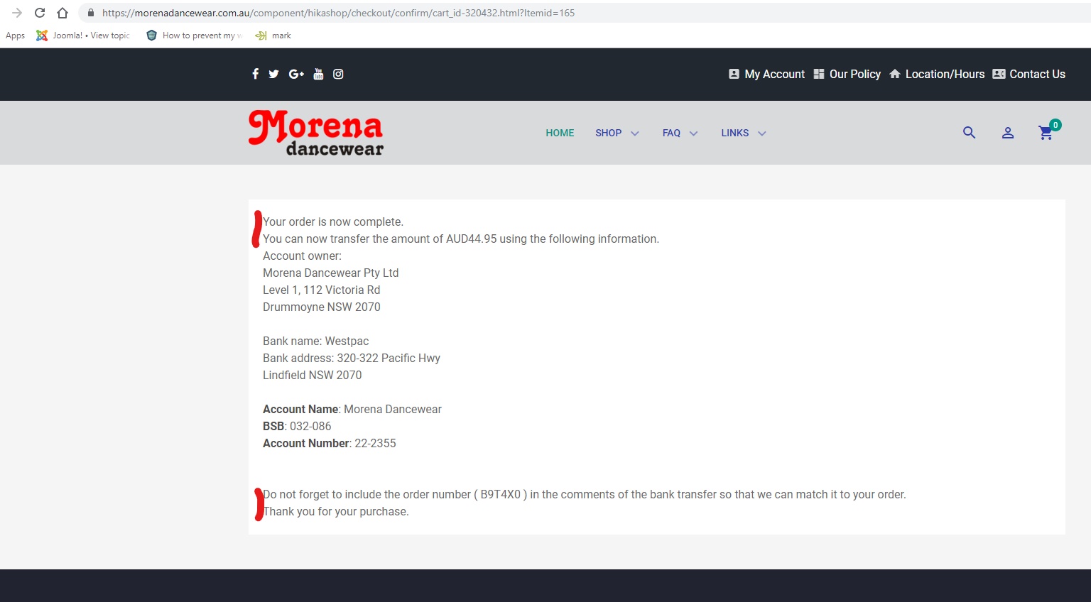

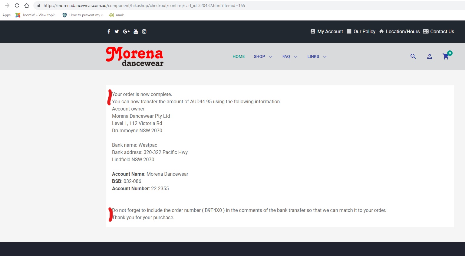

What I meant by leading and ending texts are those displayed when the order has been placed. I have attached an example of these texts for the Bank Transfer Payment Plugin.
What I would be after is a payment method that doesn't include these texts (somehow inserted by Hikashop scripts), is there such payment plugin?

You can modify the Bank Transfert "end order view", for make this follow me step bt step :
- Go to YourWebsiteUrl\plugins\hikashoppayment\banktransfer
- open the banktransfer_end.php and edit it for have something like this :
<div class="hikashop_banktransfer_end" id="hikashop_banktransfer_end">
	<span class="hikashop_banktransfer_end_message" id="hikashop_banktransfer_end_message">
		<?php echo /* JText::_('ORDER_IS_COMPLETE').'<br/>'.
		JText::sprintf('PLEASE_TRANSFERT_MONEY',$this->amount).'<br/>'. */
		$this->information.'<br/>'.
		JText::sprintf('INCLUDE_ORDER_NUMBER_TO_TRANSFER',$this->order_number).'<br/>'.
		JText::_('THANK_YOU_FOR_PURCHASE');?>
	</span>
</div>
<?php
if(!empty($this->return_url)) {
	$doc = JFactory::getDocument();
	$doc->addScriptDeclaration("window.hikashop.ready(function(){window.location='".$this->return_url."'});");
Comment the 2line arround line 3 & 4 will prevent to display the unwanted text, and so have the plugin payment that fir your needs.
