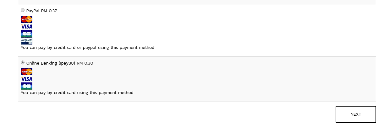

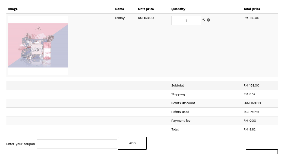

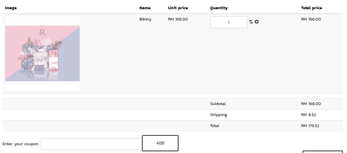

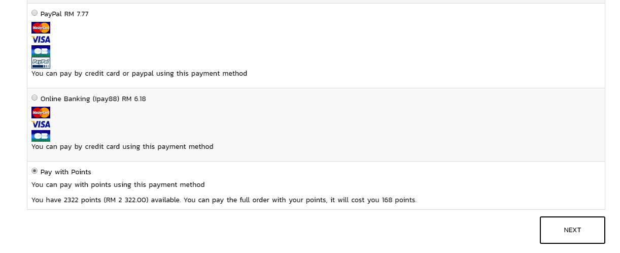

Hi There,
We have configure Userpoints payment plugin and allow users to pay with hikapoints. And we found that it is a bit confusing the users when we set the "use virtual coupon" to "yes". It will not show the payment method. And when we selected other payment method, there are fields that state the points discount and points used, not showing the points balance. But when we set "use virtual coupon" to "no", the payment method appears and clearly stated the points will be used and current balance points.
