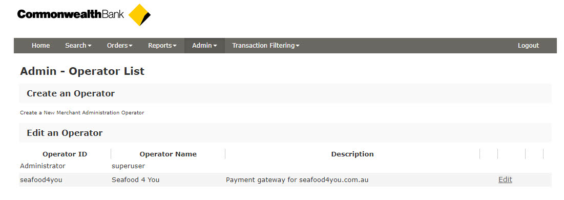

Hi, I have set up a few MIGS gateways for Zencart, Virtuemart & now also for HikaShop but the last one I did was a couple of years back.
I have access to the CommWeb Payment Gateway ( paymentgateway.commbank.com.au/ma ) and have followed their procedures of setting up an operator, logging into that operators account then this is where I would normally get the Access key etc. but I can see nowhere in there with reference to an Access key or Secure secret, in fact doing a google search: [commweb "access key"] yields nothing. Also I would like to note that the CommWeb is in Test phase and not live.

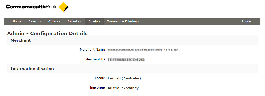

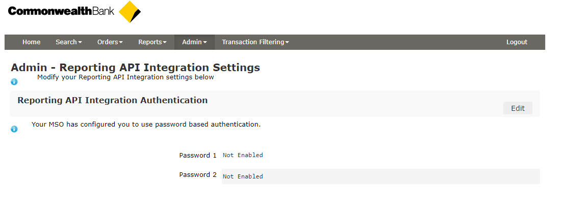

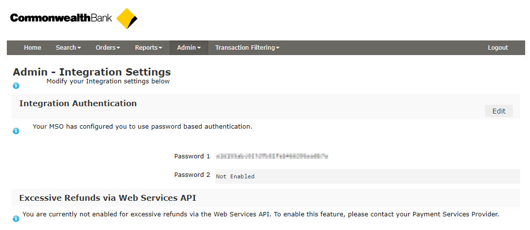

I have used your guide here: www.hikashop.com/support/documentation/1...nt-migsvpc-form.html but when it gets to the Access Key, as you know it just reads "Access key : Your MIGS access key." Believe it or not this is the best help out there I've seen for this. I've found that usually when there is no help on forums or the internet it is because it is so simple it needs no explanation or it's just not that popular, I know it's not the last one. So I am doing something stupidly wrong or have I even got the correct CommWeb system??? I have attached screen shots of the main CommWeb Configuration areas, you can see how nothing correlates.

This question can sound funny but did you try to use your password (shown in your screenshot : commweb-ss03.jpg) as "Access key" ?

I did try the password and it gave a response of "Merchant [TESTHARDISCOM201] does not exist: Payment Server System Error" and the reason why it's done this is because...
After ringing CommWeb: Commonwealth Bank (CommWeb) are no longer offering MIGS payment gateway but now offer a newer version 2.0 MPGS, i think it is "Mastercard Payment Gateway Services"?
With my limited knowledge it sounds like the MIGS plugin is no longer compatible with CommWeb from this point onwards, now I don't know how similar MIGS & MPGS are if it is an update required or a totally new plugin??
