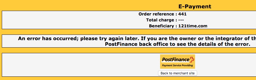

Good afternoon

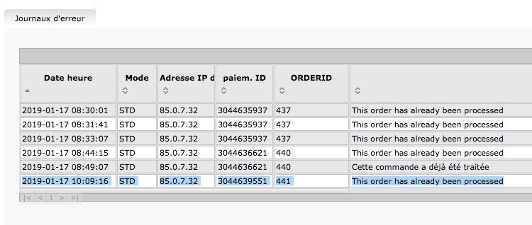

I have an issue with the function ”Payment of Orders not paid immediately” and Postfinance, Swiss well established fat provider.
When you pay an order by credit card on Postfinance, the OrderID is transmitted (Order Reference below on the image). And it can be transmitted only once according to the historical financial design of Postfinance institution.
It means that if you interrupt or cancel the transaction by closing the Postfinance transaction window, it is impossible to submit again the same order for payment since the orderID has already been used/transmitted the first time.
So we can’t use the function ”Payment of Order not paid immediately”. This must apply for all customer using Postfinance.
It was also confirmed by their customer service. There are no possibility to de-activate this ”restriction”.
I think it is completely illogical (and definitely e-commerce unfriendly) since you may want to use another card after having started the payment process, or for instance the limit was reached and you want to try later, or you changed your mind for any other reason…

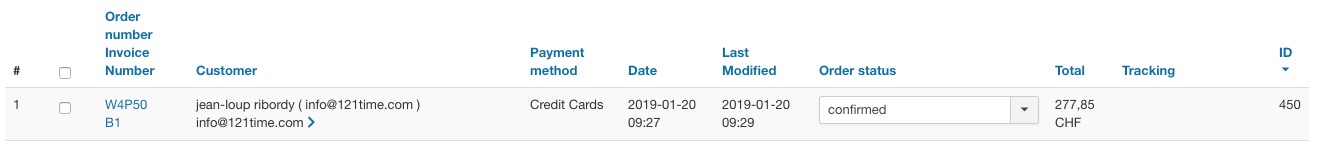

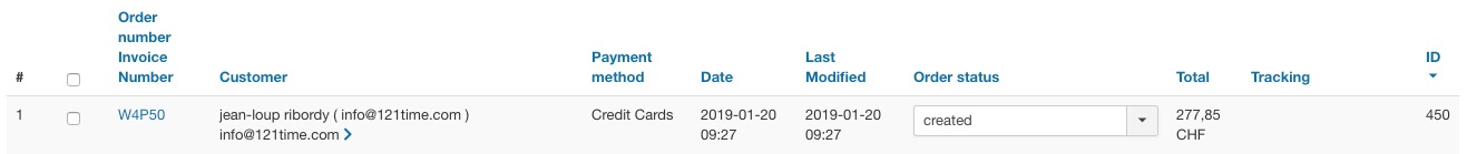

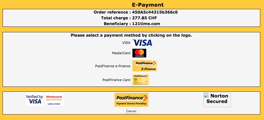

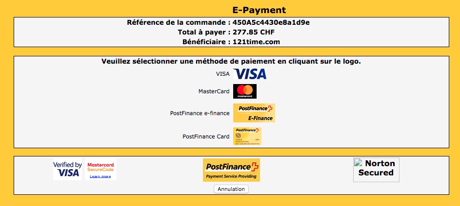

Hi Nicolas, I made a quick process illustrated, maybe will help?
First creations of the order
Then payment with credit card, the order ID are the (3) first number on the top at beginning
Then I cancelled the transaction and call it again clicking on the PAY NOW in the mail received.
Second mask with order reference on the top. The order ID is still the first numbers
So order confirmed. All good.

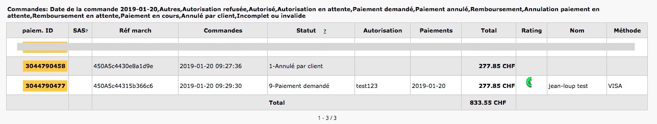

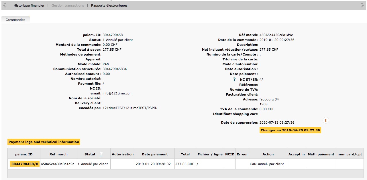

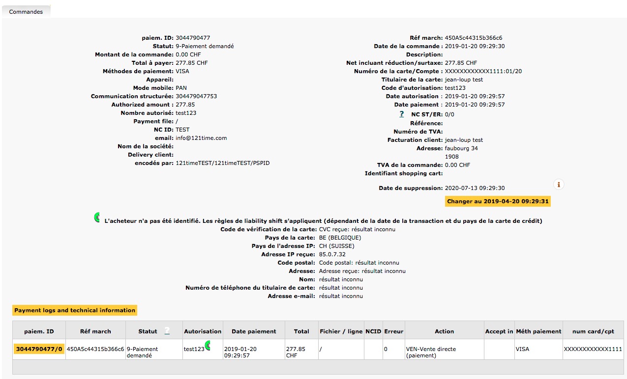

Print screen of the Postfinance transaction list from their backoffice
And no error in the postfinance logs since the modification
So as you mentioned maybe not all providers want a different ID submitted later for a same order.
You could maybe propose it as an additional option under CONFIGURATION/ORDER "Payment of order..." like "Randomize ID" that can be activated only if the customer's provider want different ID?
  • Posts: 166
  • Thank you received: 6
7 years 8 months ago #302783
And the 2 reports of the transactions on Postfinance
Transaction aborted
Transaction acheived
