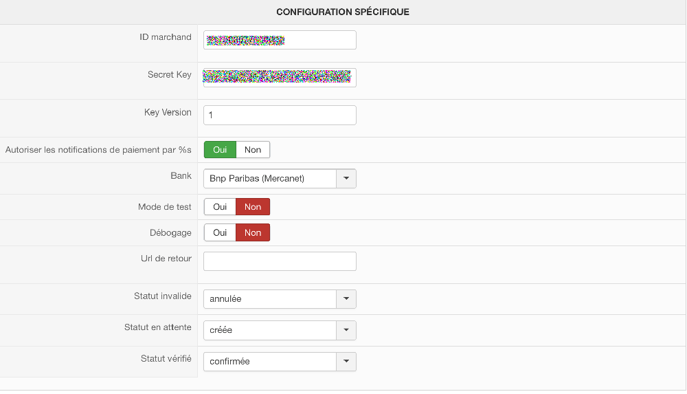

7 years 7 months ago #303144
Thanks for your answer here is a screenshot of the plugin
I'm gonna give you super user access so you can check more easily
