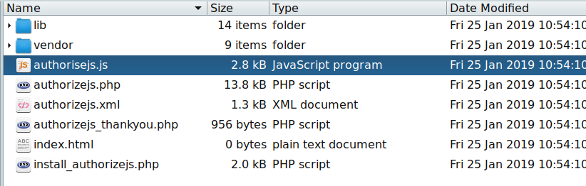

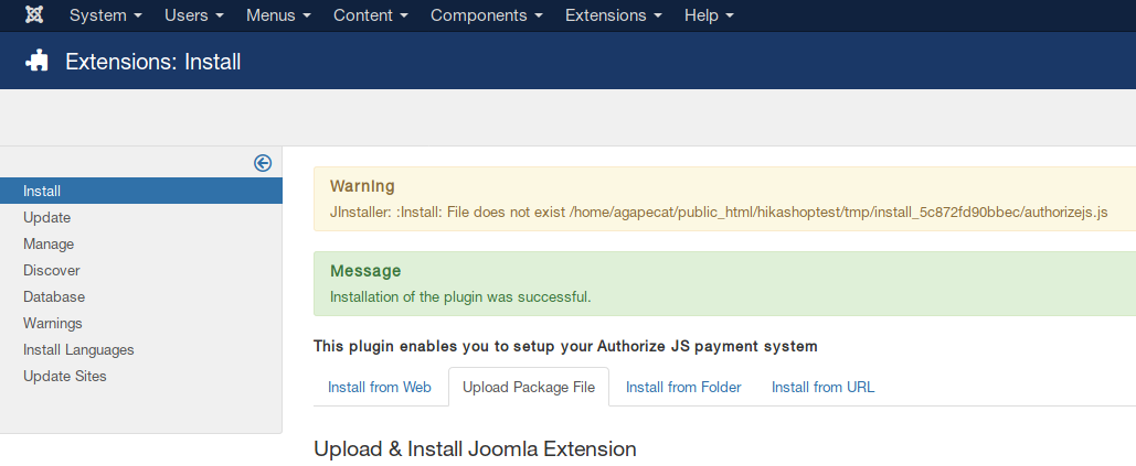

We noticed an issue right away upon installation. We get a warning about a non-existent file:

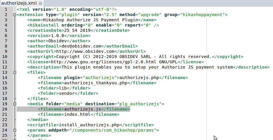

I looked in package and saw a file named "authorisejs.js". Other files were named using a "z" instead of an "s".
I checked the XML file and saw that the file name is referred to with a "z".
I renamed the file to "authorizejs.js" and reinstalled. The error disappeared.

In your latest build -- in the media folder -- the filename is still misspelled. It is "authorisejs.js", but it should be "authorizejs.js" (with a "z").

The filename typo and the display patches have been added into the new package.
