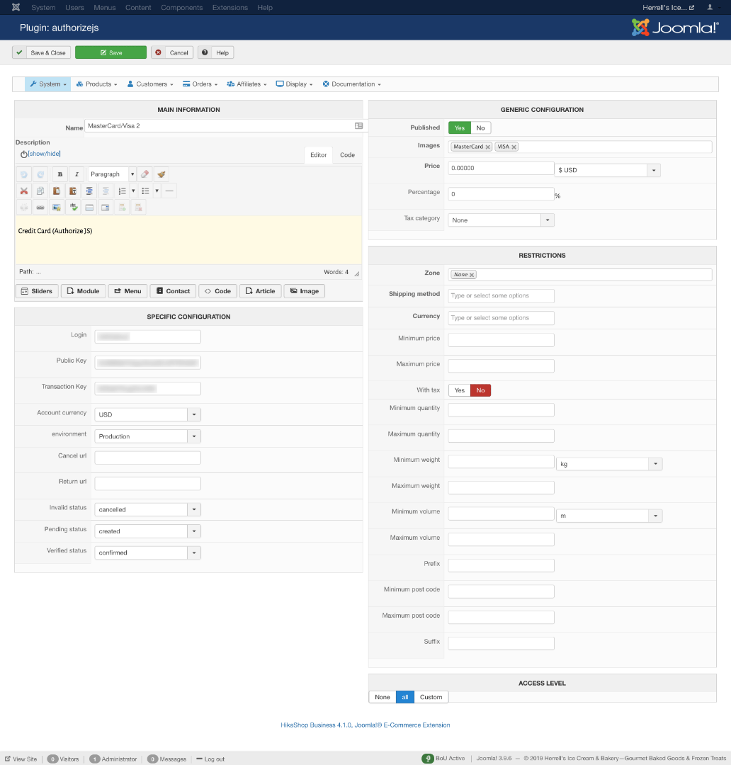

I recently installed the new Hikashop Authorize JS Payment Plugin from Obsidev on a staging site. I believe I configured it correctly; I entered the Authorize.net Login and generated a new Public Key and Transaction Key at Authorize.net. The account currency is USD; the plugin is published; and there are definitely no restrictions on zone, shipping method, etc.
However, when I place an item in the cart and go to the checkout, it says "No payment methods found."
I've double-checked all of the possible issues in the FAQ at www.hikashop.com/support/documentation/106-faq.html#paym , and I can't see any reason why the payment method wouldn't work. I've attached a screenshot with the login and keys blurred out. I'd appreciate any help you can offer!

1 - Can you please verify that you are not using the legacy checkout ? (in your HikaShop configuration, for the legacy settings)
2 - Can you please verify that your front-end website is right in HTTPS ?
AuthorizeJS is using a JavaScript file from Authorize website and that script require HTTPS ; so the plugin add the payment plugin only if you're in HTTPS.

I have been using the legacy checkout option, and I was accidentally not using HTTPS. When I switch to HTTPS and set Legacy Checkout to No, I'm able to successfully complete the checkout process and send the $ to Authorize.net.
