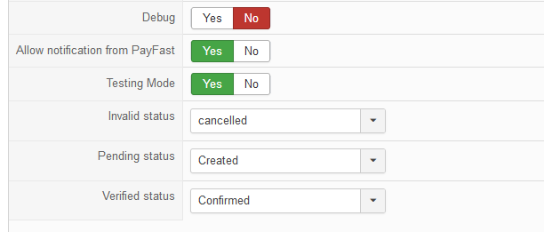

We have checked in the payment plugin settings and the settings are displayed correctly from what we could determine from the forum posts?
Is there something amiss?
How do we resolve this issue?
