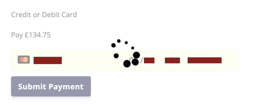

Just purchased and installed the Stripe v3 plugin "Hikashop Stripe Connect Payment Plugin" v1.0.4 and am getting very poor results.
Firstly is 1.0.4 the latest version?
With Payment Interface set to:
Card (3D-secure) - after entering the card details you just get the spinner icon forever.
Card (by Stripe Token - Legacy) I get the following: "Received unknown parameters: name, address_line1, address_city, address_state, address_zip, address_country.

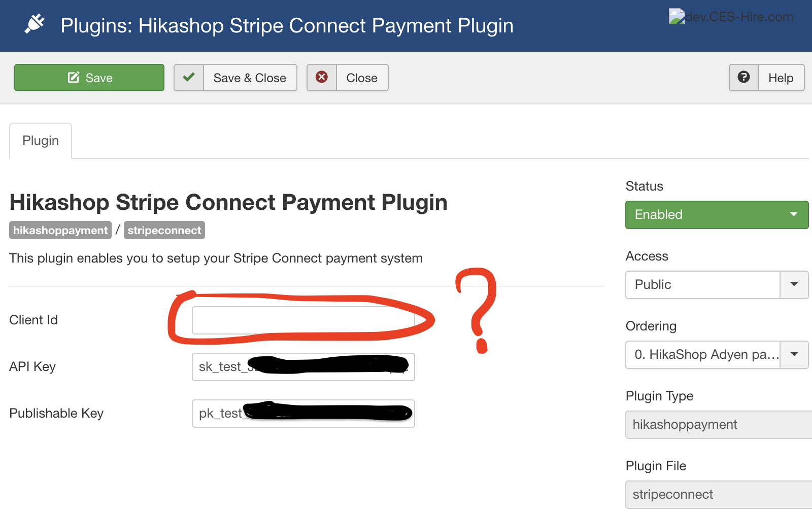

Also the Stripe Connect plugin has an extra field called Client ID - after talking with Stripe, they could not tell me what this field might be for, and its not listed in your documentation. Can you tell me what should be entered here?

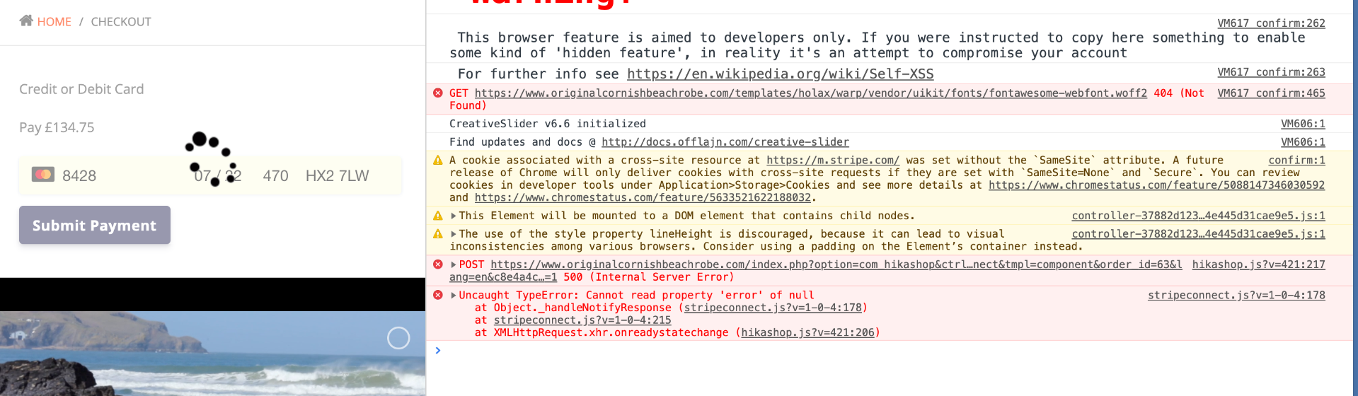

From PHP error log:
[20-Sep-2019 11:18:30 CST6CDT] Stripe Notice: Undefined property of Stripe\Customer instance: sources
But I think this might be before I disabled the Stripe V2 plugin. There are no other error messages here.
From the JavaScript Console while:
Failed to load resource: the server responded with a status of 500 ()
/index.php?option=com_hikashop&ctrl=checkout&task=notify¬if_payment=stripeconnect&tmpl=component&order_id=54&lang=en&5ea93a7ec65722427e7002f00e54ff4e=1:1
Uncaught TypeError: Cannot read property 'error' of null . stripeconnect.js?v=1-0-4:178
at Object._handleNotifyResponse (stripeconnect.js?v=1-0-4:178)
at stripeconnect.js?v=1-0-4:215
at XMLHttpRequest.xhr.onreadystatechange (hikashop.js?v=421:206)
Last edit: 6 years 11 months ago by spotstv.

6 years 11 months ago #311360
So it requires a test with the joomla debug mode activated and the network console.
Only with that it will be possible to see the content of the 500 error page and have the details of the error.

Unfortunately, the "har" file is not what is required. And it do not include the Ajax call which contains the 500 error page.

As explained previously, the PHP error log would be required to understand what is the 500 error.
Otherwise, if you have the Joomla debug mode activated, you should be able to see the error details within the ajax call (it requires to see the content of the page in the network tab of the browser console).
