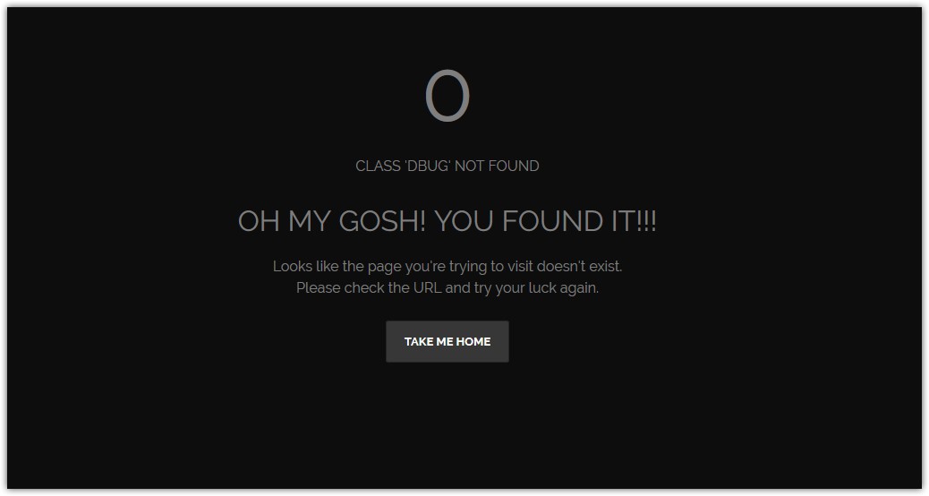

-- Error-message(debug-mod must be tuned on) -- : 0 Class 'dbug' not found
I am trying to set up the new Stripe connect payment method. When going to the point where the credit card details are entered I get a 404 page with the message "0 Class 'dbug' not found".

The only screen message is on the 404 page (url: https://###/checkout/checkout/confirm)

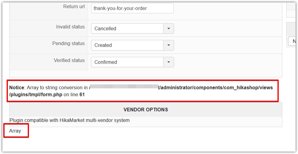

There is also an error message at the bottom of all the payment and shipping plugin pages:
In the /administrator/error-log file I found this:
I have also tried switching to the Beez template and cutting .htaccess to the bare minimum.
Code:
[02-Oct-2019 13:18:58 UTC] PHP Deprecated: Methods with the same name as their class will not be constructors in a future version of PHP; plgZeroWeight has a deprecated constructor in /###/plugins/hikashop/zero_weight/zero_weight.php on line 11
[02-Oct-2019 13:19:25 UTC] PHP Notice: Array to string conversion in /###/administrator/components/com_hikashop/views/plugins/tmpl/form.php on line 61
[02-Oct-2019 15:21:18 UTC] PHP Deprecated: Methods with the same name as their class will not be constructors in a future version of PHP; plgSystemmaximenupatchck has a deprecated constructor in /###/plugins/system/maximenupatchck/maximenupatchck.php on line 16
