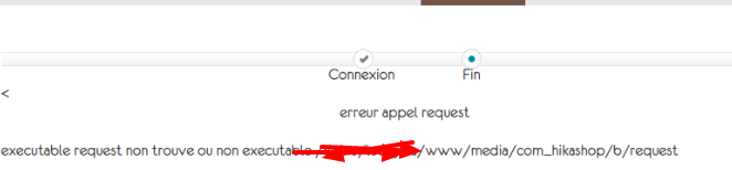

i have enabled plugin "HikaShop SIPS Atos payment plugin" and make order through Bank Order. but getting error
erreur appel request
executable request non trouve ou non executable /home/www/media/com_hikashop/b/request
I have added full permission for request folder and
my request file is 64-bit and server is 32 bit .
Please also check attachment with error message.
Please give me solution about same.

You need to go in FTP in the folder /home/www/media/com_hikashop/b/
There, check that you have the file "request". It must not be a folder but a file.
That file should normally be provided to you by your bank (along with the certificate, and the response file).
Also, check the permissions of that file. It should be executable not only readable.
Also, make sure with your bank that the file you're using is the correct one. They have several formats for the request and response files. One for windows servers, one for linux servers, etc.
I would also recommend to double check that your server is 32 bits and not 64 bits (most servers since several years ago should be 64 bits). And if it's really 32 bits, check with your bank tech support that the 64 bits version you have is compatible.

Well I don't know what you changed but I already told you the solution.
Please follow the instructions I gave in my previous message.
Check whether the files are there and if they have the correct permissions (777 if you're unsure).
Since you're on the same server as before and it was working before, then you must have the correct files, so it can only come from the files not being there or not with the correct permissions.
I don't see any other reason it would generate that error message.
There is only one ATOS SIPS v1 payment plugin for HikaShop.
The ATOS SIPS v2 plugin included in HikaShop is not supported by your bank (although it is much easier to setup as it doesn't require binary files like ATOs SIPS v1)
