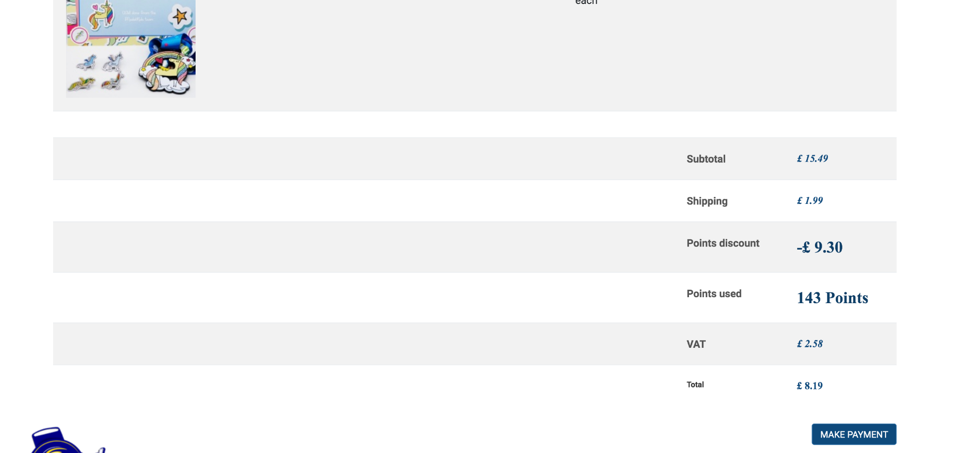

HI,
I had an issue with the points (used as a virtual coupon) not deducting when a user pays via paypal. The full payment was charged. I saw the solution was to disable this send details button. Which we did and the amount charged via paypal was now correct.
But this cannot be a permanent solution? That means we will have to manually adjust this information in our accounting system for every order to take into account VAT and Shipping?
Has there been a fix for this since the past post we found, so that the PayPal charges the correct amount as well as being able to receive the details of an order?

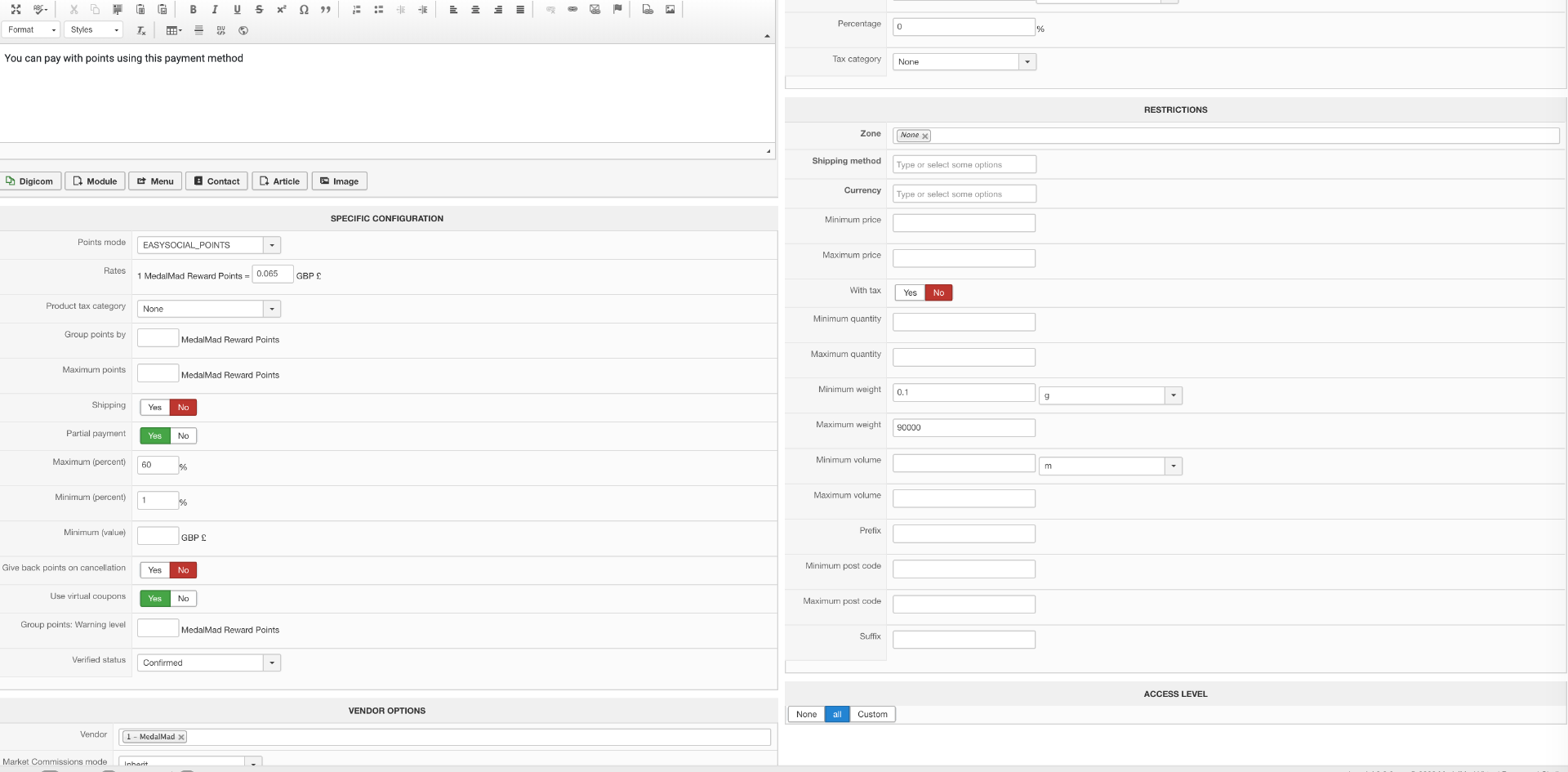

Could you provide screenshots of your points plugins settings and PayPal payment method settings ?

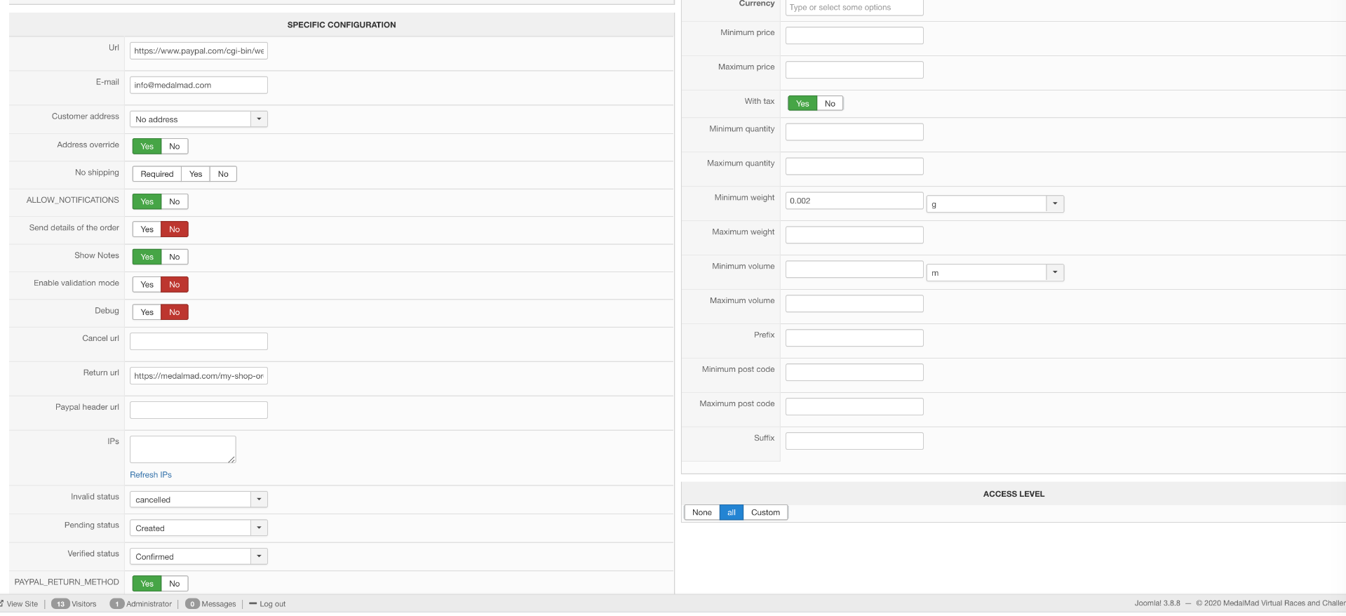

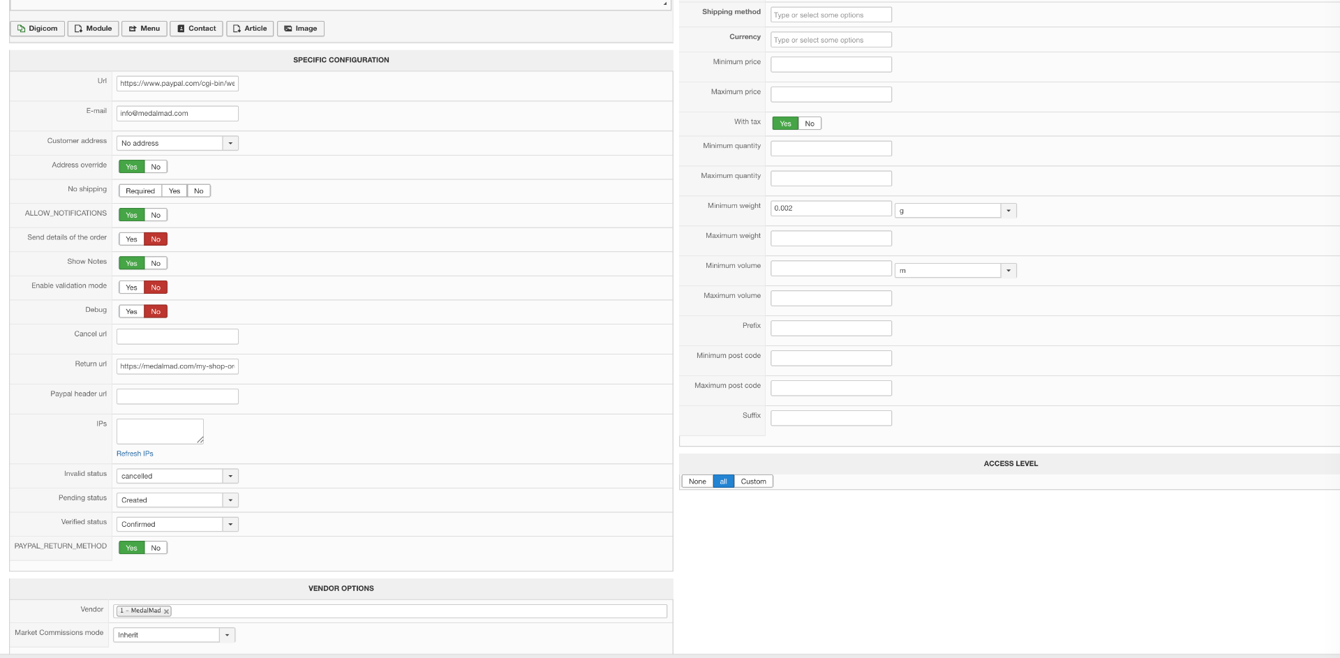

  • Posts: 25
6 years 7 months ago #315757
We are running 4.2.2 only installed a few weeks ago.
Attached are the screenshots of the payment plugin (with send details disabled)

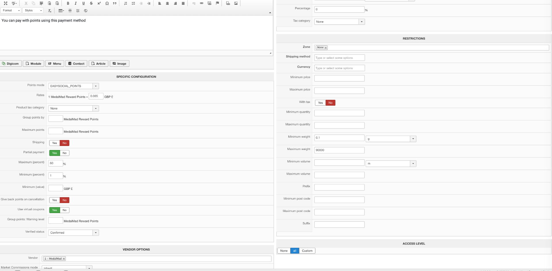

  • Posts: 25
6 years 7 months ago #315758
Sorry,
just to add the points plugin setting if need.
Mike
  • Posts: 86218
  • Thank you received: 14222
6 years 7 months ago #315761
Could you please activate the "debug" setting of the PayPal payment method, do a test payment reproducing the error and provide a copy of the "payment log file" that you can get under the main tab of the HikaShop configuration afterwards, as well as a screenshot of the details of the order in the backend ?
That way, we should be able to better understand what's going on as it is supposed to work as far as I know and as far as I can see in the code of the PayPal plugin.

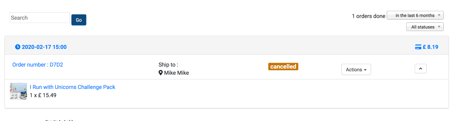

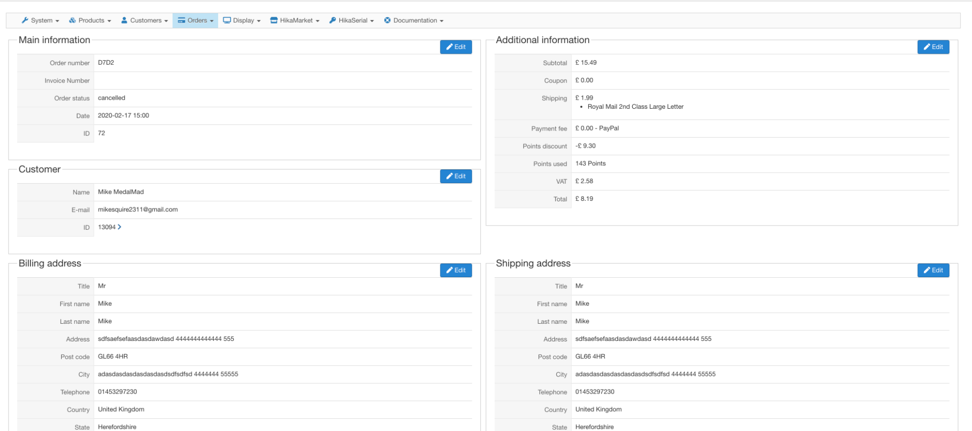

  • Posts: 25
6 years 7 months ago #315780
Debug was was turned on.
Order went through but charged full amount. Order came back as cancelled though it was successful. Shows payment as it should ahve been with points deduction.
See attached screenshots for order details. How do you want the log file as I am unable to upload it here?
Mike

  • Posts: 86218
6 years 7 months ago #315800
Thanks for that.
I was able to understand the issue. It comes from a side effect of another fix we had to do to avoid HikaSerial loosing data in the cart because of the email preloads in some cases. This removed the additional data added by the order creation process and which the PayPal plugin needs when sending the order details.
I've added a patch for that on our end.
Download the install package of HikaShop on our website and install it on yours and it will add the patch.
