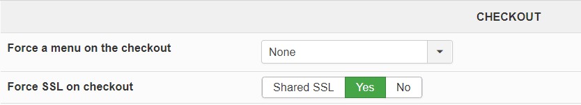

For example, could you provide screenshots of the menu item(s) settings of your checkout ? And what did you configure in the "force a menu on checkout" setting of the HikaShop configuration ?

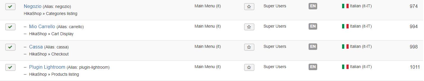

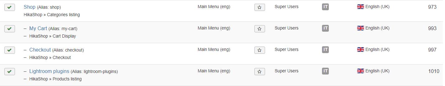

Ok Nicolas, here all the details. English works, Italian does not. No Falang usage.
If you need more info, I am here.
thanks

Itemid= 997 and 998 are the menu item id for the checkout, the first in English (and restricted to English only), the second in Italian (and restricted to Italian only)
