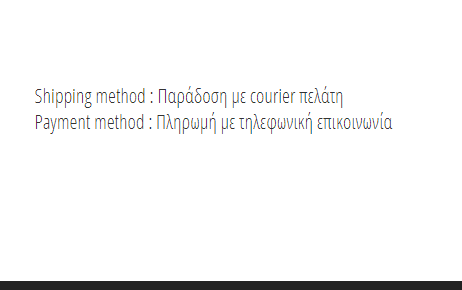

I have a question regarding one of the texts showing in the tab that displays an order that has just been made. To make you understand what I'm saying, the steps go as follows: Add product to cart > complete order > text 'see your order here' appears > I press on 'here' and then a page shows up. At the bottom, there's this text that I will show you in a picture that I need to remove, or even change it somehow, if possible.
The 'payment method' and 'shipping method' texts need to go.
I figure that I could remove it with "display: none", but I do wonder if there's another way.

If you follow the instructions of Philip, you'll know which view file to edit after activating the "Display view files" setting and accessing that page. You can read more about this there:
Looking at your screenshot, it's probably the order / show.php view file that you'll want to edit to remove this area.
That area is displayed by this code:
<tr>
			<td>
<?php
	if(!empty($this->shipping)) {
		echo JText::_('HIKASHOP_SHIPPING_METHOD') . ' : ';
		if(is_string($this->order->order_shipping_method)) {
			if(strpos($this->order->order_shipping_id, '-') !== false)
				echo $this->shippingClass->getShippingName($this->order->order_shipping_method, $this->order->order_shipping_id);
			else
				echo $this->shipping->getName($this->order->order_shipping_method, $this->order->order_shipping_id);
		} else
			echo implode(', ', $this->order->order_shipping_method);
		echo '<br/>';
<?php
	if(!empty($this->payment)) {
		echo JText::_('HIKASHOP_PAYMENT_METHOD') . ' : ' . $this->payment->getName($this->order->order_payment_method, $this->order->order_payment_id);
			</td>
		</tr>
