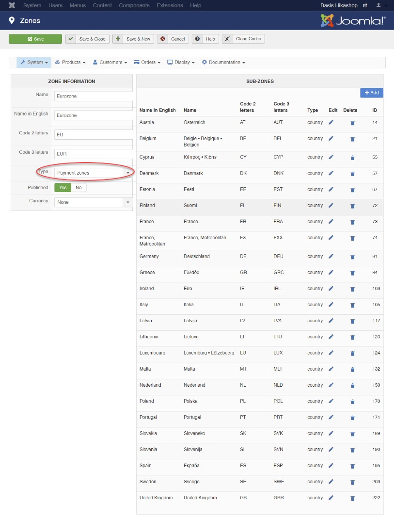

Hi Supportteam,
I have read in this post ( www.hikashop.com/forum/payment-methods/8...nt-zone-charges.html ) that the purpose of payment zones is to be used to create groups of countries and states, so that you could easily select the payment zone in the "zone" restriction setting of payment methods. Then, the system would automatically display the payment methods based on the state/country selected by the customer.

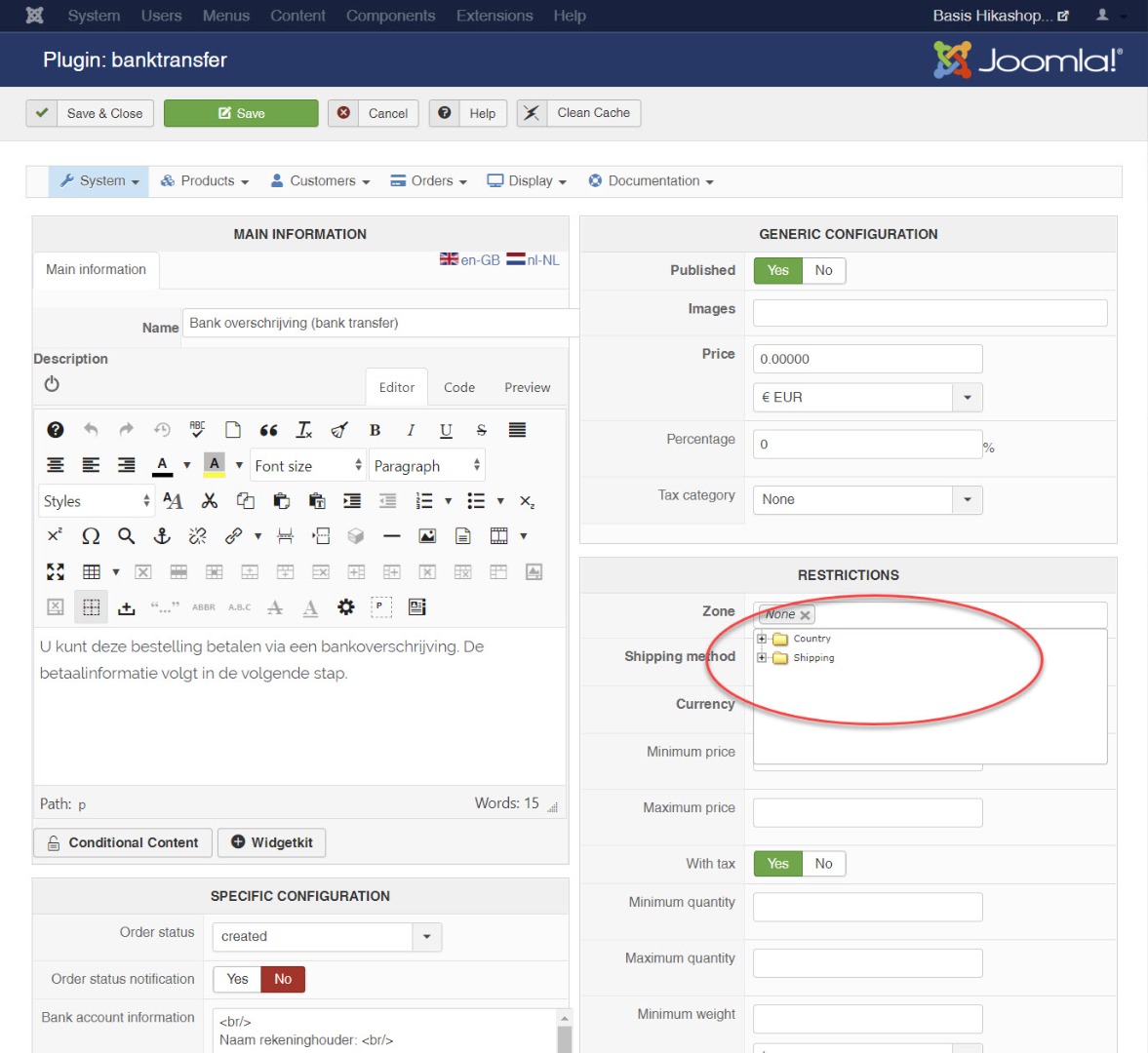

But when I create a payment zone it's not visible at the payment methodes.
See screenshot:
Hope you can help me.

6 years 4 months ago #318214
Thank you for your feedback. I've added a patch for that on our end.
You can download the install package of HikaShop on our website again and install it again on yours and it will add the patch.
