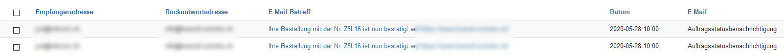

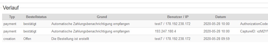

I did a lot of testing with developer of Saferpay Plugin (webit.bz). I got new version of Plugin. Problem is not solved. The developer said:
It should not be a problem of the plugin, as it does not send any (success) email anymore.
In email history and order history I have double entries of emails (please see screenshots).
Any idea of how to solve the problem?
Thanks.
Thanks.
6 years 5 months ago #319910
by nicolas
Replied by nicolas on topic Double order emails since update to 4.3.0
I've provided more information to webit.bz about the issue. Hopefully, they'll be able to give you a final solution with that extra information.
