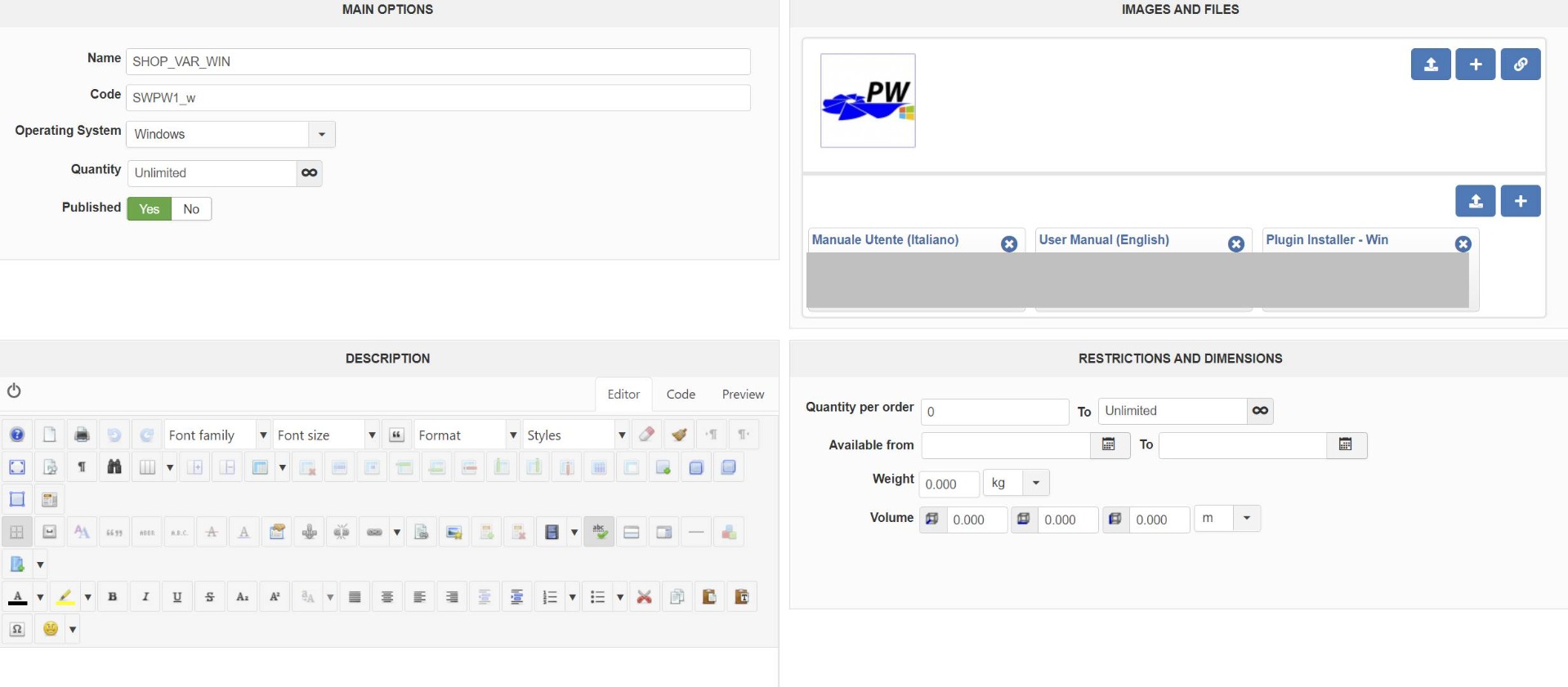

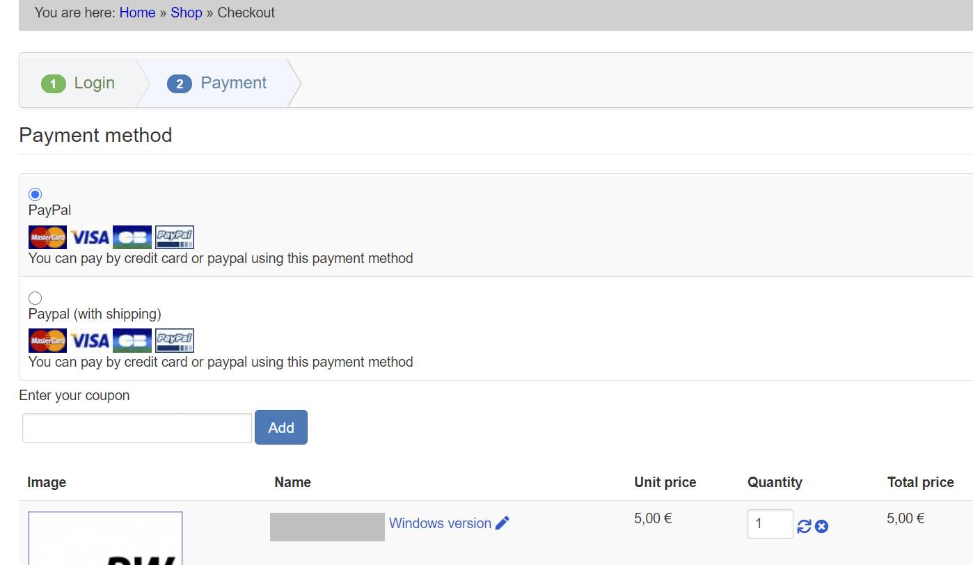

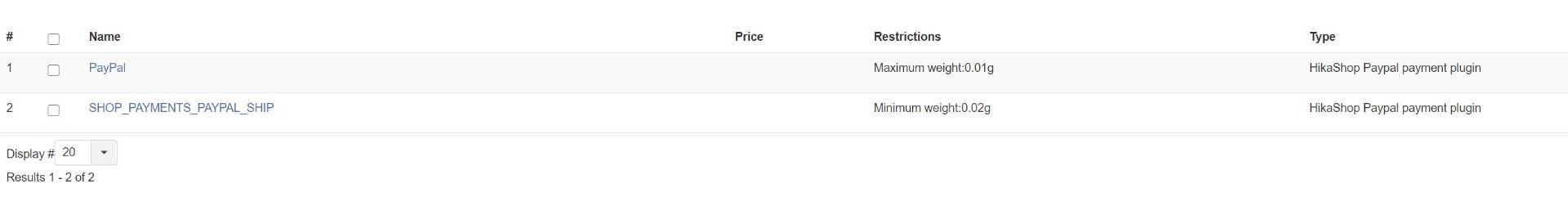

5 years 11 months ago #324337
Sure, here you have:
  • checkout where both paypal plugins now appear
  • restriction of payment plugins
  • product variant configuration with no weight
let me know if you need more info
thanks and best regards
Giuse

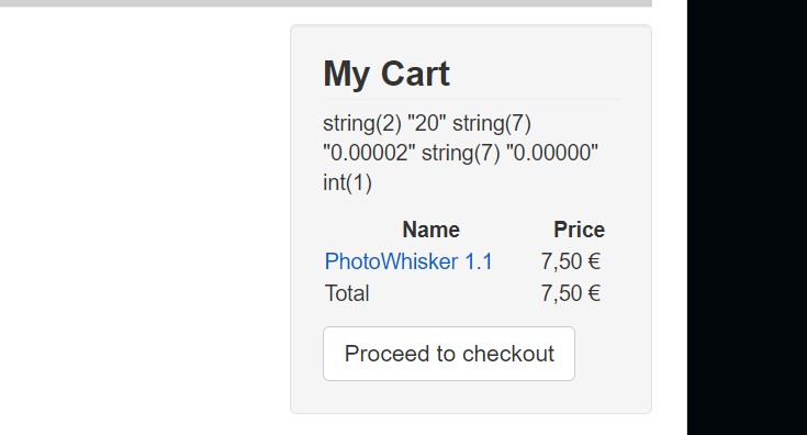

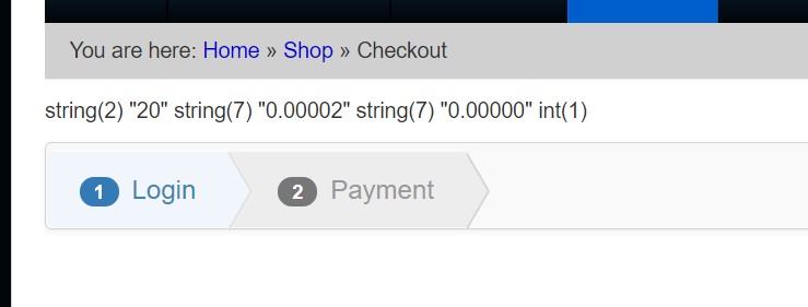

5 years 11 months ago #324706
Hi and thanks. Now the weight restriction seems to work correctly.
Your patch added some logs to the front end as attached that should be removed.
When will this patch be included in the official download to update real sites?
thanks
Giuse
5 years 11 months ago #324713
You're right, some debug code was left, it should be better now. Thank again for your feedback !
