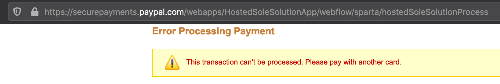

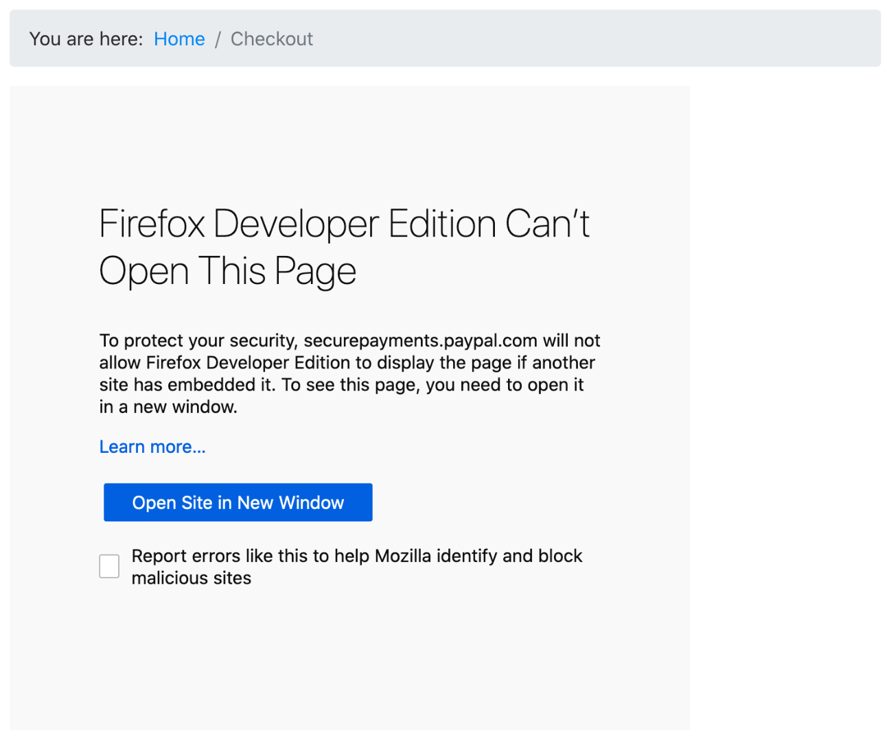

-- Joomla version -- : 3.9.23
I have an issue with the Hikashop Paypal Website Payments Pro Hosted Payment plugin. I have it published and active on my site, when I go through the checkout process and select it as a payment option it fails with an x-frame cross scripting issue. I cannot get the plugin to work with either run in iFrame Yes or No setting.
Please see the attached screenshots. Does anyone have the PayPal Hosted plugin running successfully? Can you advise on how you have the configuration setup.

It seems that the iframe mode of Paypal Website Payments Pro Hosted is not allowed anymore by PayPal.
But with the "iframe" setting turned off, it will work without an iframe, so it should work fine. I don't see how you could get that same error with the iframe setting turned off. Could you please double check ?
