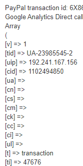

I think I've just about isolated the issue. I performed tons of test purchases, watching the cookie contents change before redirection to paypal and after redirection back to the website.
With direct call disabled and commented out in function "googleProcess":
everything works properly. Either the session info is pulled properly from the UTM parameters or pulled from the __utmz cookie. However, one of two things happen:
1. Customer successfully redirects to website after payment on paypal (auto redirect takes a little over 10 seconds) and all session info is logged properly with the transaction.
2. Customer does not redirect and not transaction data is logged in Google analytics (makes sense).
However, with direct call turned on and the above code is uncommented, the transaction data in google analytics lacks all session info. Since customer doesn't need to redirect back to website, transaction data is sent automatically when payment notification is sent from paypal to website. Two weird things happen:
1. If UTM parameters are specified, everything is logged properly.
2. If UTM parameters are not specified, the session info from the __utmz cookie is not sent properly with the transaction. I'm not sure why this would not break, but it seems to be related to using the __utmz cookie info in the direct call. Perhaps the __utmz cookie parameters aren't being used properly in the googleDirectCall function?
If the __utmz cookie hypothesis doesn't explain the issue, I'm all out of ideas... Is there a way to see the full array sent to Google Analytics when transaction is complete? If the result is empty fields for the case where UTM parameters are not specified in the URL, that would confirm that the __utmz params are not being pulled into the direct call method?

I believe i have solved the issue. Universal analytics does not create any cookies:
stackoverflow.com/questions/18604715/goo...-missing-utmz-cookie
In hikashopanalytics.php, the campaign name, source, medium, etc. is being pulled in via the __utmz cookie which apparently was how ga.js (old google analytics) stored session/campaign info. In the googledirectcall function, the session/campaign info is being scraped from the __utmz cookie or utm tracking parameters and sent along with the transaction info. In the case of UTM tracking parameters in the link, everything is fine since you can override session info just like you have it currently set up:
However, in the case of no UTM tracking parameters in the URL, a packet with empty values for session info was being sent to google analytics:
Therefore, if I comment out the campaign specific information, all tracking in google analytics works perfectly (since nothing is overwritten) and all transaction show up now since the customer does not have to redirect back to the website. I kept wondering why everything looked fine before and after payment, but the transaction itself had the wrong campaign/session info. I will continue to monitor over the next 24 hours to make sure everything is logging correctly before closing this issue on my end.

'v' => 1,
'tid' => $account,
'uip' => $order->order_ip,
'cid' => @$params['uuid'], // clientId
'ua' => @$params['ua'], // user-agent from browser : navigator.userAgent
'cn' => @$params['cn'], // campaignName
'cs' => @$params['cs'], // campaignSource
'cm' => @$params['cm'], // campaignMedium
'ck' => @$params['ck'], // campaignKeyword
'cc' => @$params['cc'], // campaignContent
'ci' => @$params['ci'], // campaignId
'ul' => @$params['ul'], // language
It seems analytics.js is a lot smarter than ga.js. However, Google tag manager (gtag.js) is a lot smarter than both of these, and might be a viable path forward since analytics.js can be loaded through tag manager.

I must say that I'm not familiar with GA and its API, and it seems that they changed stuff over the years with different ways of going things so it's starting to be a big mess.
If I understand correctly, you mean that you removed the lines:
from the googleDirectCall function and then it worked fine because the values in $params were empty and adding these variables meant that GA would override the value it already had on its end by an empty value ?
In that case, I suppose that the best would be to add a check to only add them to the $data array if they are not empty.
Thanks for your research on the subject.
Code:

That is correct. However, a much more elegant method would be to check if empty as you mentioned.
The API for ga.js and analytics.js is highly confusing. With gtag.js, everything is supposed to be more simplified. I plan on trying to make a hikashopanalytics.php implementation using gtag since most of the configuration is done through the google tag manager and little has to be managed on the website itself.
At any rate, i would at least check if the @$params is empty or not before setting the campaign specific info in the transaction packet sent to GA. I would imagine this particular issue affects anyone who upgraded to analytics.js (universal analytics). Very annoying problem that's taken a long time to wrap my head around.
Wouldn't have been possible without your previous changes with implementing the __utmz cookie check. Ultimately, this is what led me to the solution. Thanks again!

Here is the code we'll have in there starting next version:
Great.
Thanks for working with us on this issue.
Code:
$data = array(
'v' => 1,
'tid' => $account,
't' => 'transaction',
'ti' => $order->order_id, // order_id
'ta' => $siteName,
'tr' => round($this->convertPrices($order->order_full_price, $currencyInfo->currency_code, $to_currency), 2),
'tt' => round($this->convertPrices(($order->order_subtotal - $order->order_subtotal_no_vat) + $order->order_shipping_tax + $order->order_discount_tax, $currencyInfo->currency_code, $to_currency), 2),
'ts' => round($this->convertPrices($order->order_shipping_price, $currencyInfo->currency_code, $to_currency), 2),
'cu' => $to_currency
// adding variables only if not empty to avoid overwriting them on GA's side
$variables = array(
'ua', // user-agent from browser : navigator.userAgent
'cn', // campaignName
'cs', // campaignSource
'cm', // campaignMedium
'ck', // campaignKeyword
'cc', // campaignContent
'ci', // campaignId
'ul', // language
foreach($variables as $variable) {
if(!empty($params[$variable])) {
$data[$variable] = $params[$variable];
